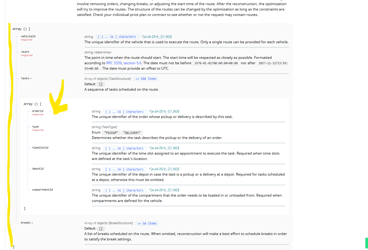

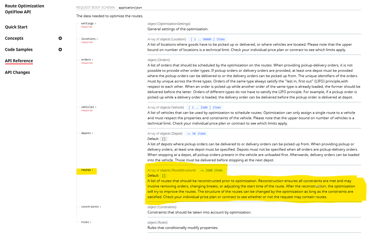

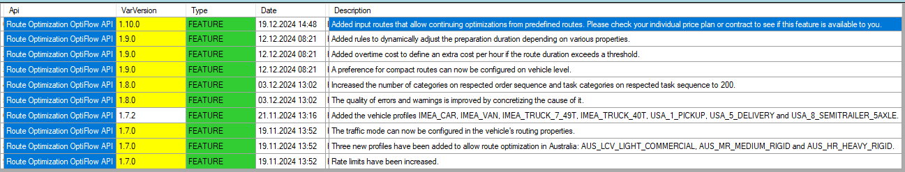

Brand new feature in Route Optimization OptiFlow API:
  • Added input routes that allow continuing optimizations from predefined routes.
  • Please check your individual price plan or contract to see if this feature is available to you.
