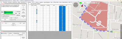

car profile - all segments on the reference track are "residentsOnly==false"

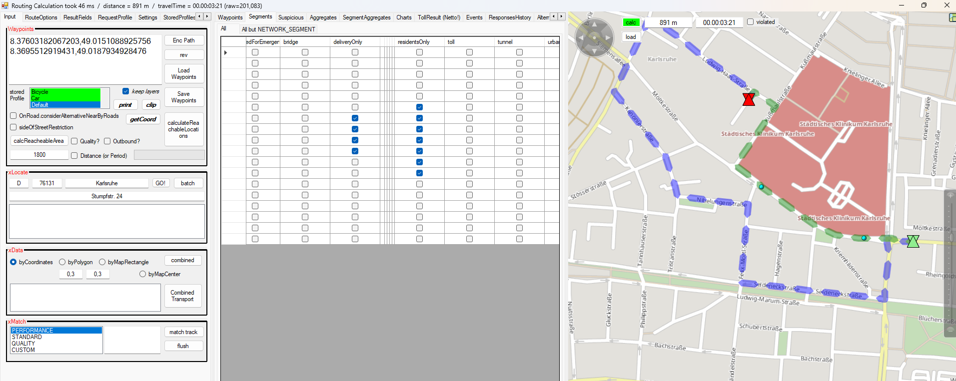

default profile: the blue route occurs if no additional "residentsOnlyMalus" is set. I managed to get the green (=desired) track by setting the rsidentyOnlyMalus to 0.

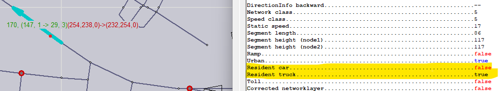

What I do not get:
Why are some of the segments seen as residentsOnly relevant based on the vehicle profile? Istn't the property independent from the used vehicle?
And the answer is: the assumption above is wrong. In fact there are two separate properties describing the residents handling:
