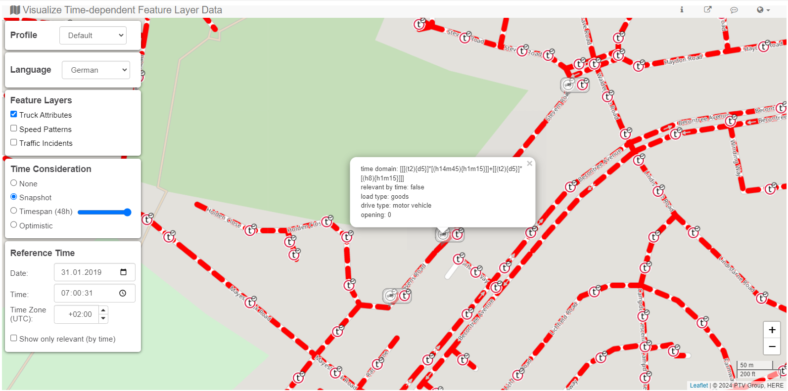

Recently I've been asked for the consideration of areas around schools, in this particular case in the area of London (UK):
There's no dedicated FeatureLayer for the data, but these restrictions seem to be part of the regular PTV_TruckAttributes and modelled with time dependency.
- mayor-hails-success-of-schools-streets-programme (www.london.gov.uk)
- school-streets-list-2022.pdf (content.tfl.gov.uk)
This GDF time domain's meaning is:time domain: [[[(t2){d5}]*[(h14m45){h1m15}]]+[[(t2){d5}]*[(h8){h1m15}]]]
relevant by time: false
load type: goods
drive type: motor vehicle
opening: 0
- [[(t2){d5}]*[(h14m45){h1m15}]] : weekdays between 14:45 - 16:00
- [[(t2){d5}]*[(h8){h1m15}]] : weekdays between 08:00 - 09:15
