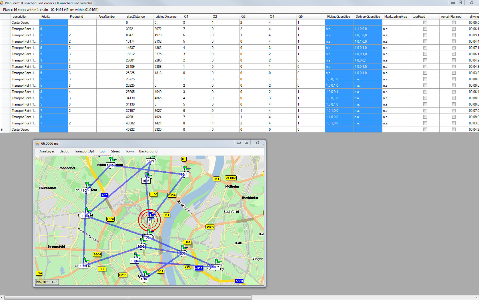

I added those examples to my testclient. Feel free to evaluate the screenshots. Important: there's sufficient amount of time so the PRIORITY will not cause a selection of scheduled versus unscheduled orders.
In this situation neither order priority nor pickup/delivery has an impact on the TourSection. Each stops TourSection is set to 0 which means &quot;I don't care about a predefined sequence&quot;. <br />Result: pickups and deliveries are alternating. So do the prios (9,7,5,3 and back to 5)
In this situation neither order priority nor pickup/delivery has an impact on the TourSection. Each stops TourSection is set to 0 which means "I don't care about a predefined sequence".

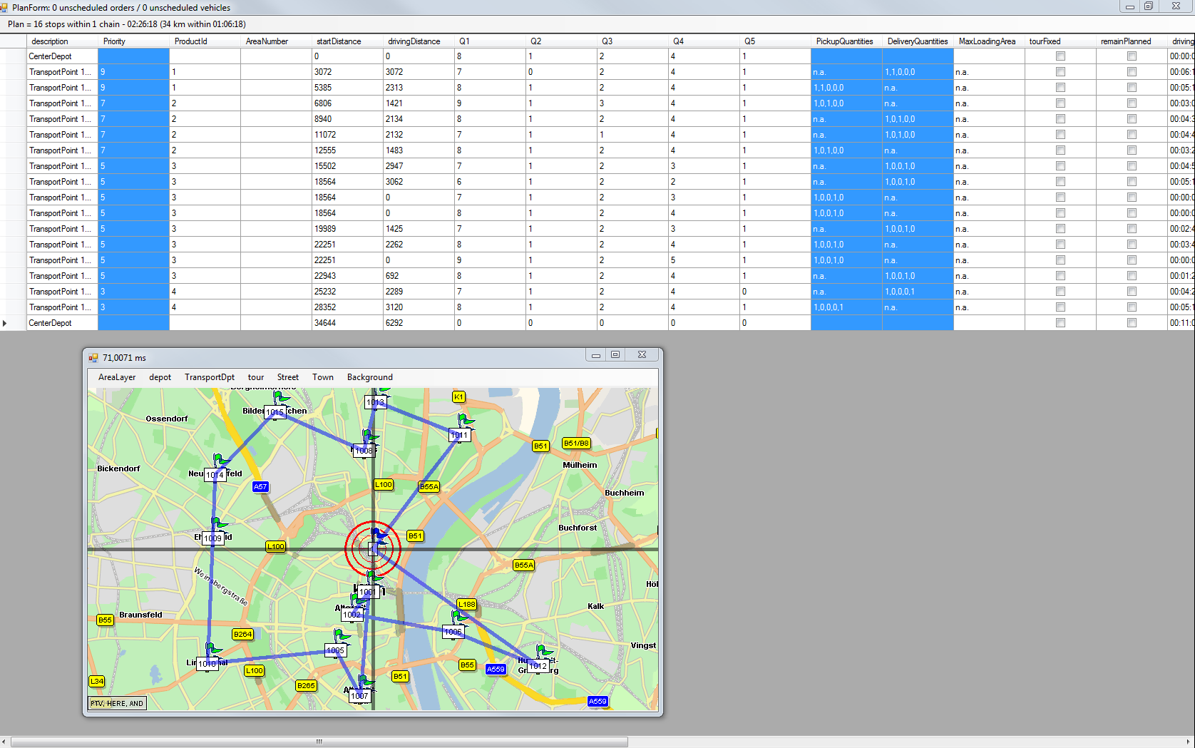

With this approach I set Delivery orders to TourSection=2 and Pickup orders to 999. <br />Result: The vehicle is unloaded and once it is empty we start to collect things on our way back.<br />Priorities alternate up and down.<br />This is useful for CEP services who usually want to unload the vehicle and then start to pick the returns.
