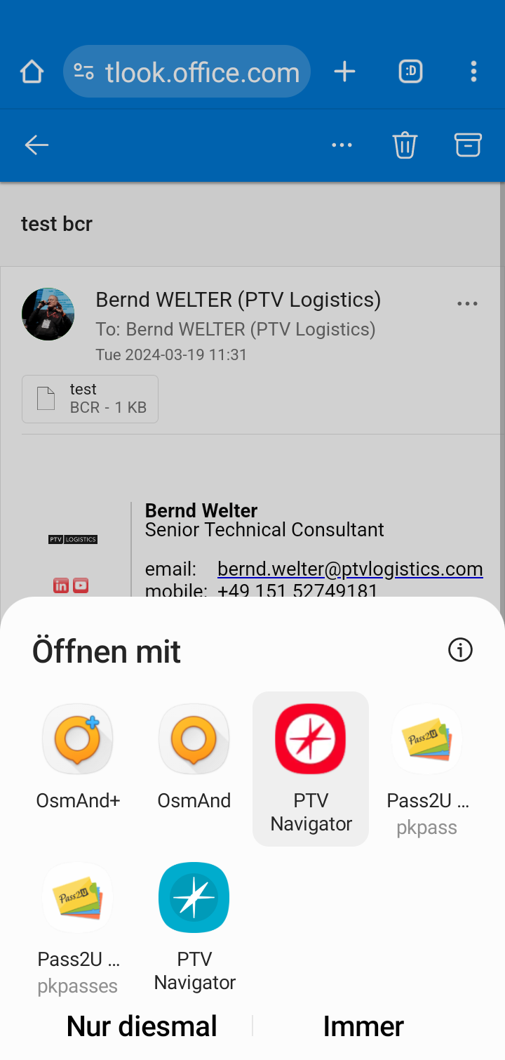

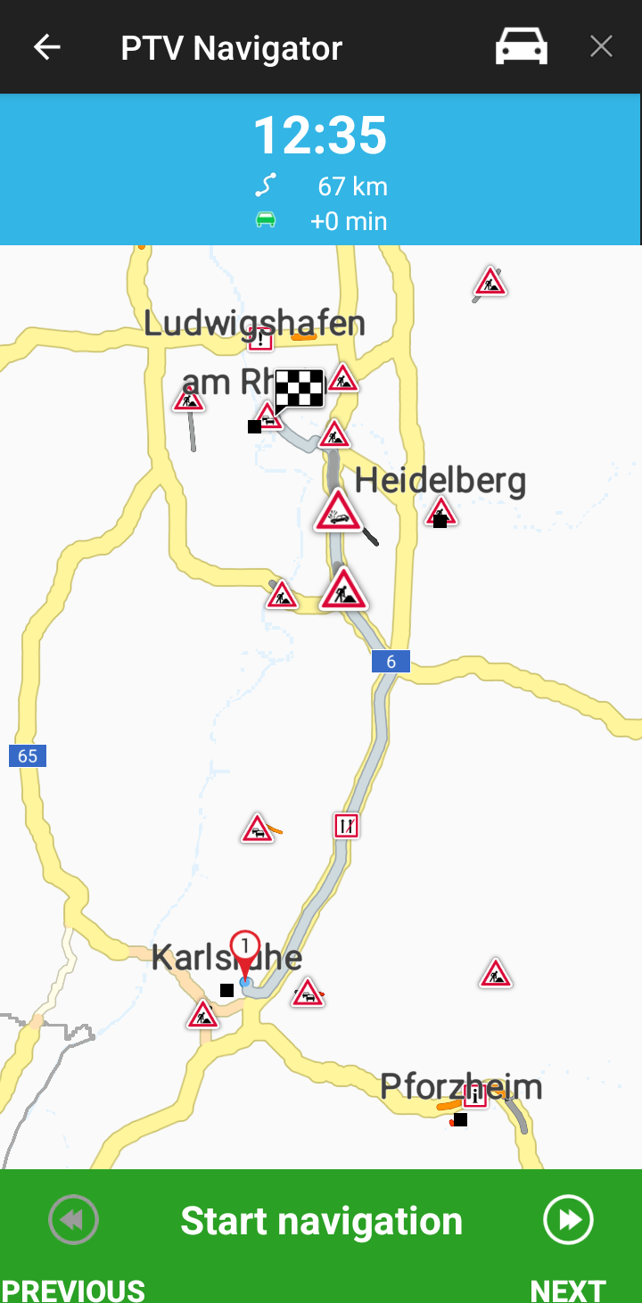

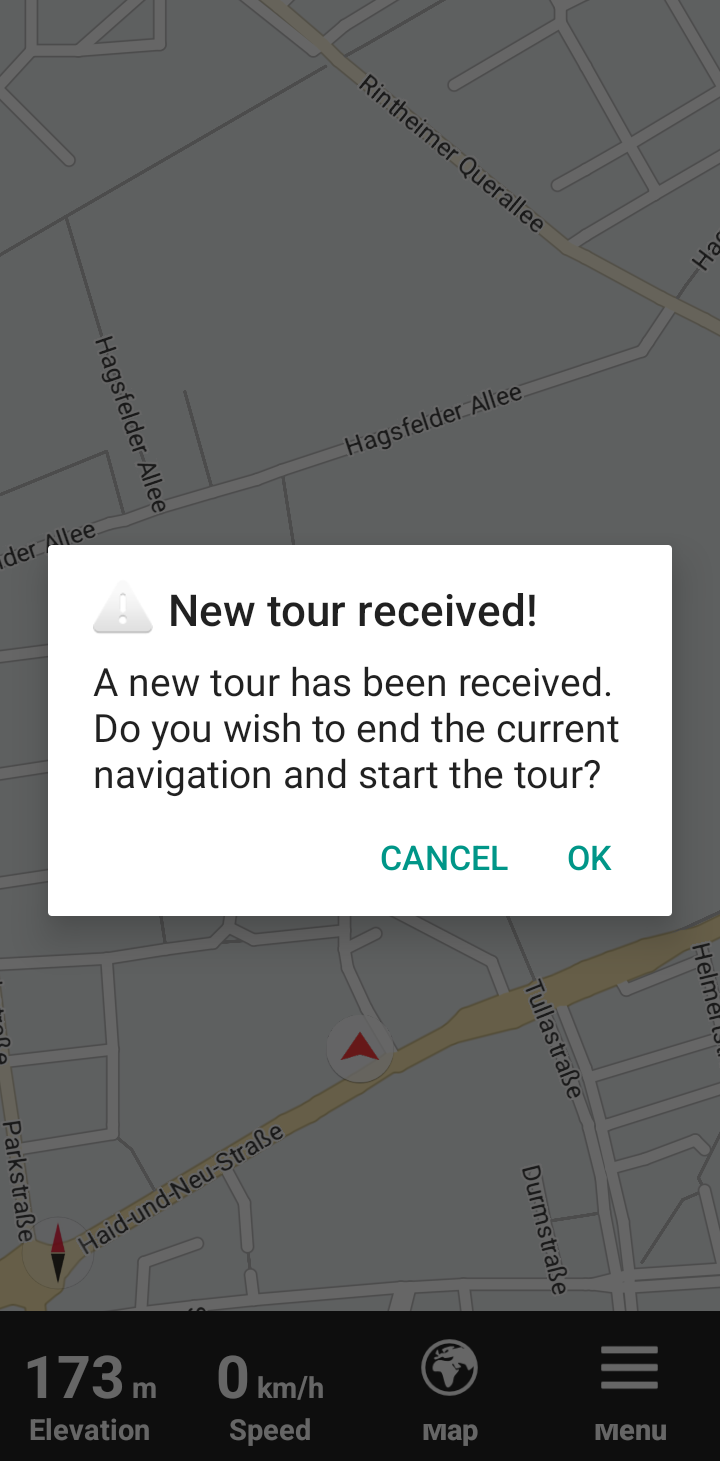

Here's how you can evaluate a BCR file on the mobile PTV Navigator (version1) for Guided Navigation...
There might be alternative ways, but this is just one approach that is easy for quick tests...
Send the BCR file as an attachment via email... Try to open it on the mobile device... Select the PTV Navigator from the list of apps that are assigned to *.BCR files
