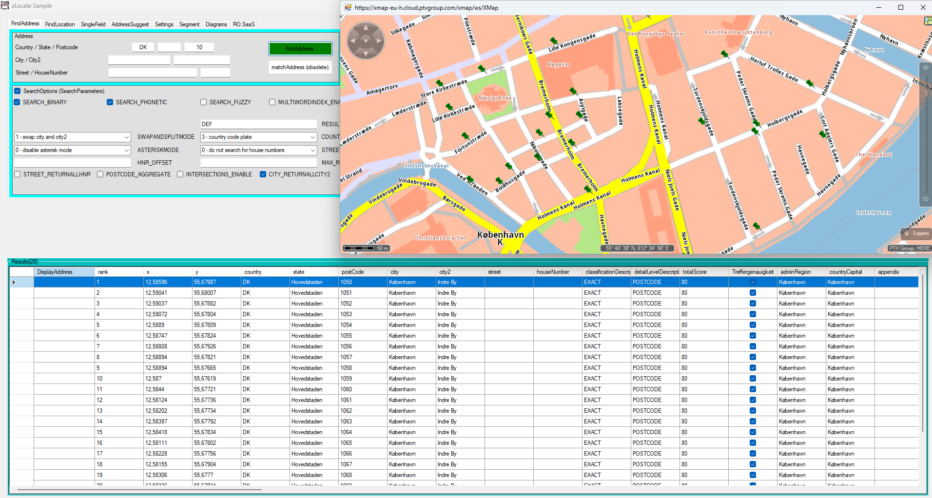

Here's the output I get from xLocate 1 by entering
Country = "DK"
PostalCode = "10"
xLocate1 - offers many switches...
If I repeat this with xLocate2 / Developer Geocoding the result list is empty...

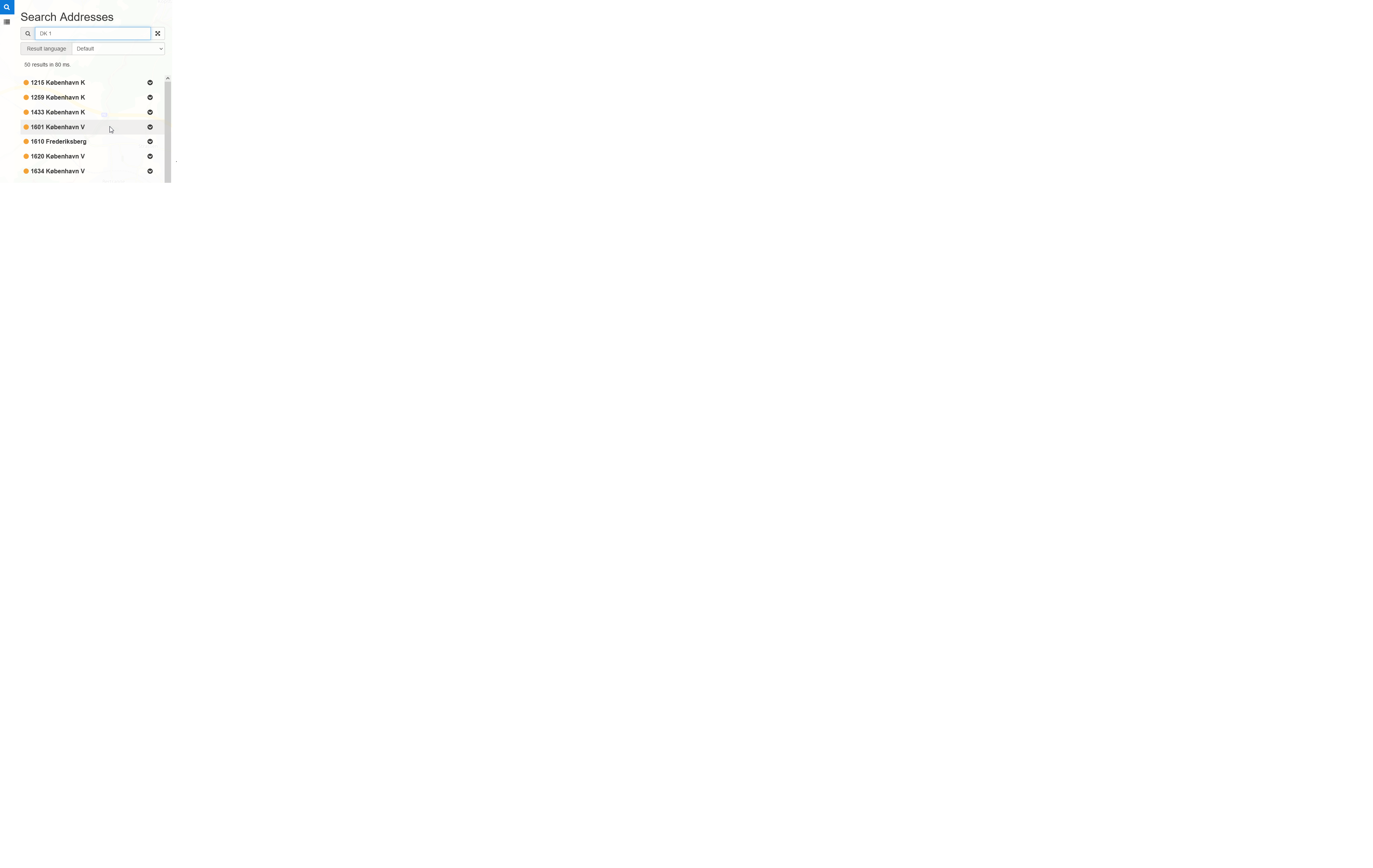

An astrisk search is not implemented for the xL2 multifield search. But the asterisk search was implemented for the xL2 singlefield search:
If you need it for the multifield search, you may be able to use the suggestion by address search of the PTV Developer Platform. An asterisk search is implemented here but you need to combine it with the location by address search.
https://developer.myptv.com/en/document ... ns-address
The idea with the suggestion search is that you need fewer geocoding requests and a suggestion search is much cheaper compared with a geocoding request.
