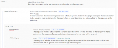

- (update 8.11.2024): If the sequence is supposed to be kept, too: use categories such as "Seq[1]", "Seq[2]", "Sewq[3]"... and constraints.orders.respectedSequences "Seq[1] before"Seq[2]" ... to ensure that given sequences are kept. Attention: there might be limits in "how many constraints are allowed"...

When sending a new request after the first run, you could include vehicle combination constraints and (if needed) respected sequences, to ensure some parts of your previous plan are re-used for the new planning. Fixing (part of) the routes will in many cases speed up the optimization, as there will be less options to explore for the engine, so you could reduce the optimization time for the second run in that case. Some small gains, at least.

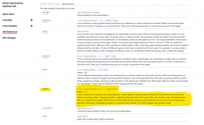

- Posts: 2934
Re: Update an existing Optimization (missing inputplan)
important in this context: We now support input plans!
Check this article
And as first questions arised:
- You can fix orders to trips and so on just with the regular constraints...
- xTour identifies which tours of an input plan are violated due to tour distance, working time, or whatever constraint. Such tours remain untouched, the violations are visible in the response. We only manipulate vehicles with no input tour and vehicles with valid tours (check this article) - these vehicles will get unviolated output tours.
- The Route Optimization OPTIFLOW API supports the use of input routes, allowing the algorithm to build on existing routes rather than starting from scratch. While the input routes serve as a starting point, the API does not guarantee that the planned orders will stay in their original positions; they are simply used as a foundation for optimization. If any constraints are violated within the input routes, the algorithm will adjust the plan by removing orders as needed to resolve the violations, ensuring that all constraints are met. The resulting optimized plan will never contain violations, even if the input routes initially had them.
