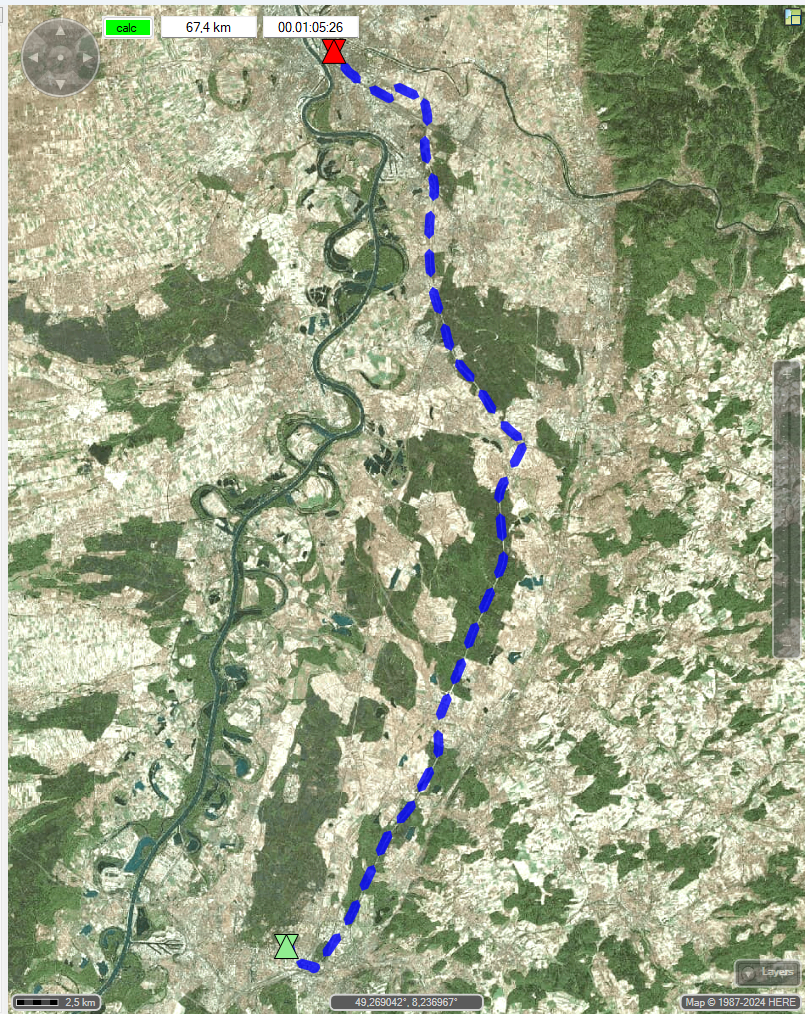

I am trying to render a ShapeLayer (my route) over a TiledLayer (satellite retrieved through PT V Developer).
For some unknown reason the route is covered by the satellite layer no matter whether the route prio is greater or lower than the satellite prio.

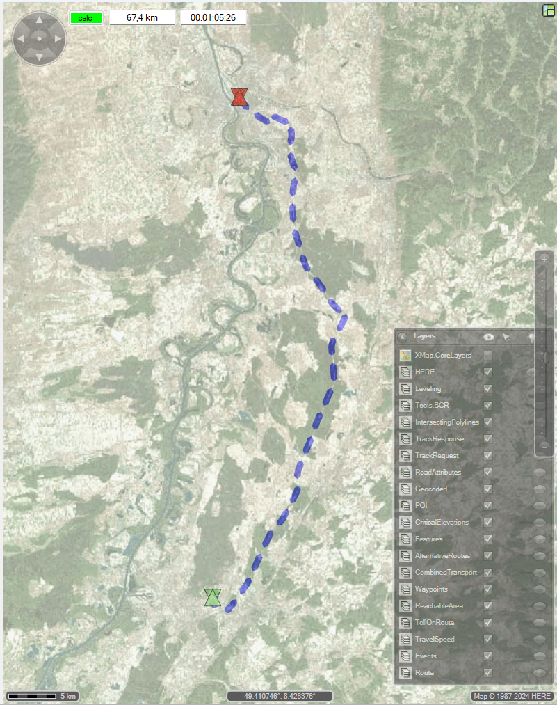

Opacity of HERE Satellite layer set to 50%: routelayer shines through.

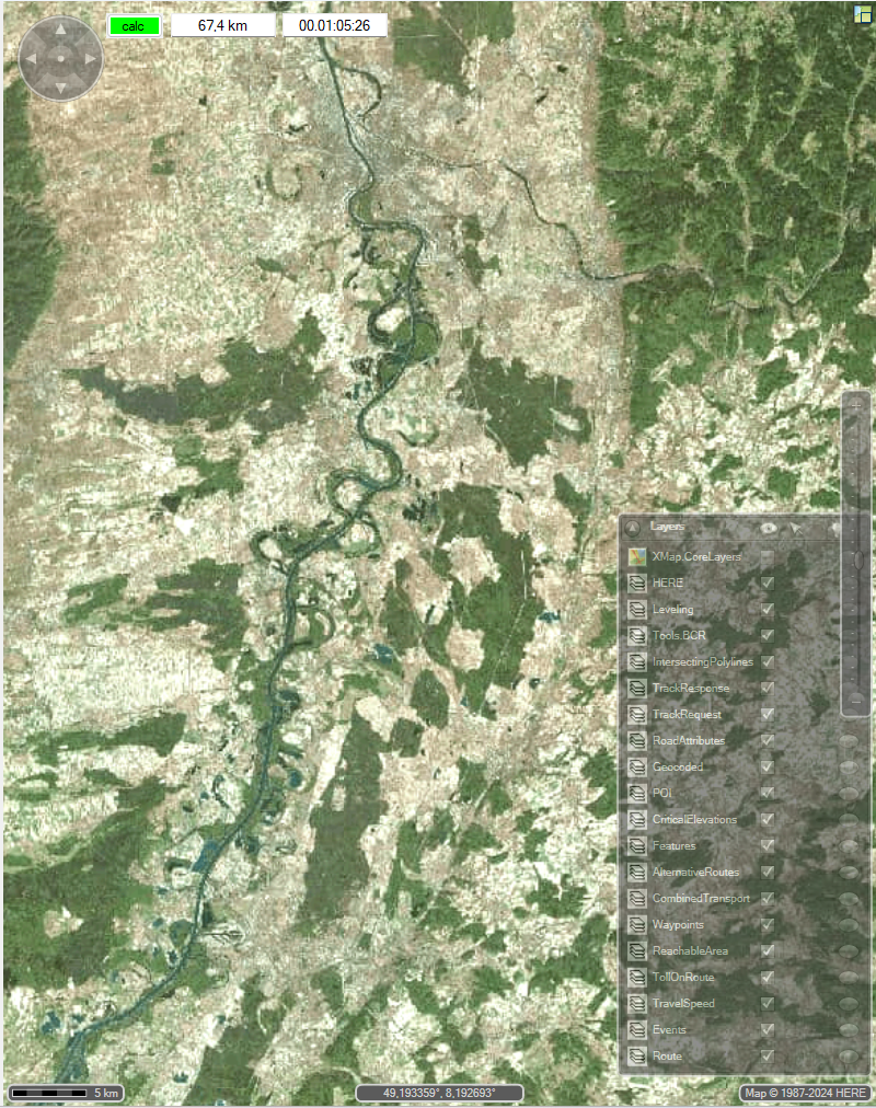

Opacity of HERE Satellite layer set to 100%: route is completely covered.
Am I misunderstanding the priority definition (aka z-index)?
