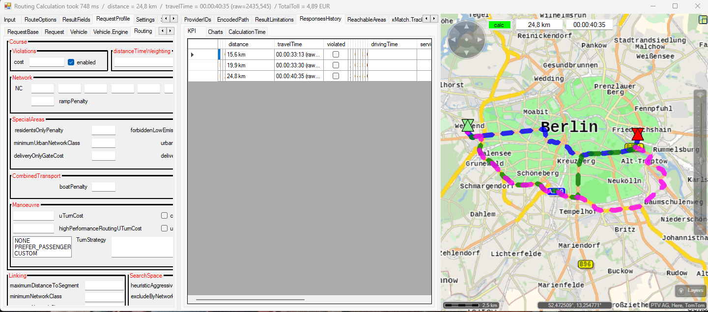

  • This picture shows the different routes of a vehicle with a DE_RED com.ptvgroup.xserver.vehicleprofile.Engine.lowEmissionZoneTypes=DE_RED in the area of a greenzone.
    I applied different values for the com.ptvgroup.xserver.routingprofile.SpecialAreas.forbiddenLowEmissionZonePenalty:
    • blue = 0 : no additional costs for the usage of unmatching segments applies: the route takes a path straigth trough the zone.
    • green = 50 : small impact - the route takes a balance between direct connection and a compareably short transit through the zone.
    • purple = 500 (or more) : the route takes a path around the zone and uses a minimized transit through the zone.

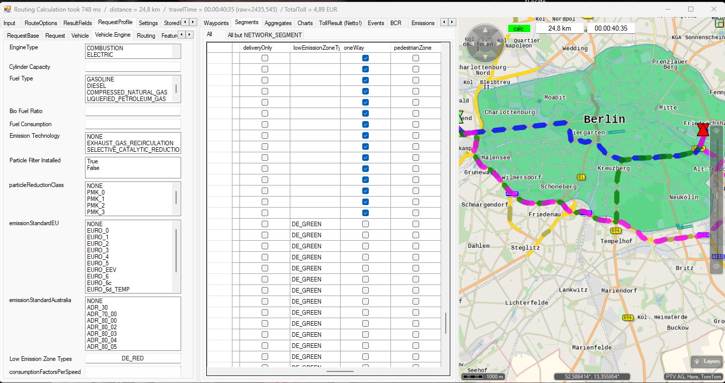

  • How to detect segments where the vehicle's zone type is not sufficient for the segment? Here you have to look into the segment's list and the lowEmissionZoneType property of a segment. There's no dedicated "violated" or "insufficient" flag given so if you know the vehicle's value is "DE_RED" while some segments require DE_YELLOW or DE_GREEN you have to mathch the segments by yourself.

what do I have to do so that the xServer sets the violated flag to true for the forbidden segments?
