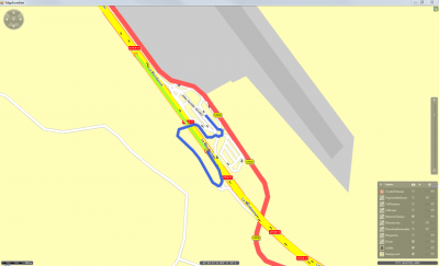

the attached screenshot gives us the required information:
- Blue segments: RESIDENTIAL attribute
The segment in blue colors belong to RESIDENTIAL category. So if you apply a malus to that street segment category the routing prefers a detour. If the malus is at 2500 (highest acceptance value) this means the routing accepts a detour that is up to 25 times as long as the original segment.
Here is the responsible section of your profile:
<BasicDataRules>
<VehicleSpecific>
<EmergencyVehicles segmentMalus="2501"/>
<ProjectSpecificVehicles blockedSegmentMalus="2501"/>
</VehicleSpecific>
<Network rampMalus="10">
<MalusByNetworkClass malus="0"/>
<MalusByNetworkClass malus="60"/>
<MalusByNetworkClass malus="70"/>
<MalusByNetworkClass malus="100"/>
</Network>
<SpecialAreas residentialMalus="2500"/>
<CombinedTransport ferryMalus="100" piggybackMalus="100"/>
</BasicDataRules>
The screenshot is based on AVOID_RESIDENTS_ONLY=0
(= I don't care whether a segment is RESIDENTIAL or not)
I think this is the mising link
If not: let me know!!
Regards Bernd

Though I still can't really understand why are these segments in the example considered as residential roads
Theoretically what roads considered to be residential? It's quite confusing, because in the example these roads only lead to a parking lot.
