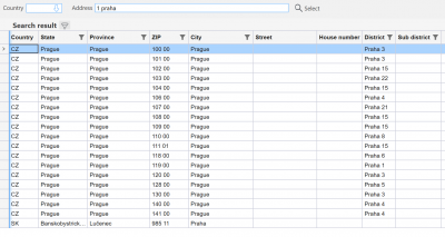

we are using PTV XServer 2.30 xLocate SearchByTextRequest to gather locations.
When entering the string "1 praha" we get 19 result rows:

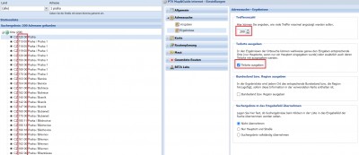

But when we enter the same string in Map&Guide Internet we receive a lot more than 19, depending on the settings made:
Question
How can we achieve that? - So that we get the same number of results in xServer2?
This is a feature that is needed a lot. Our colleagues do not want to put in every postal code code. They want to have a list of all postal codes in the city and then check all the locations they need on the map. Like in Map&Guide Internet when you click on location you see it directly in the map so they can go through the list.The need comes up to have a full list instead of entering every single postal code or gettings just a few result rows.
We had a look at the post viewtopic.php?f=11&t=1393 but the answer did not help in this case. As stated above entering "1 praha" or "praha 1" does not return all postal codes starting with 1.
Question
