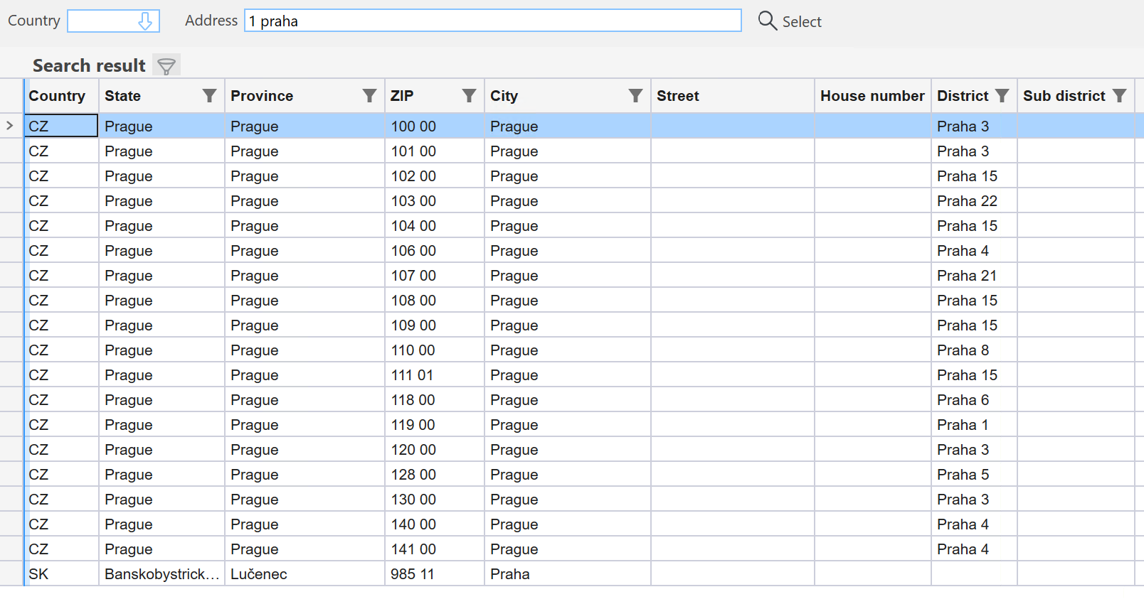

we are using PTV XServer 2.30 xLocate SearchByTextRequest to gather locations.
When entering the string "1 praha" we get 19 result rows:

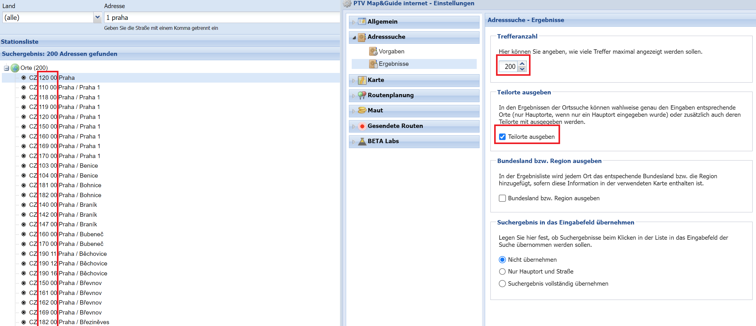

But when we enter the same string in Map&Guide Internet we receive a lot more than 19, depending on the settings made:
