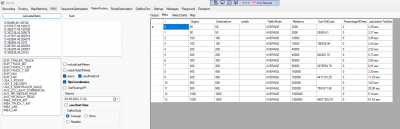

The raw data...
The raw data...

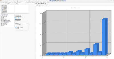

Check the bars for a better visualization. You can clearly recognize the impact of toll calculation on the performance. Kind of quadratic.<br />1st, 3rd, 5th column : without toll<br />2nd, 4th, 6th bar: with toll
