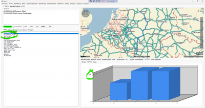

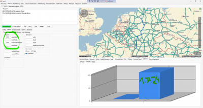

Since last week the provisional toll tarrifs for the German National Toll are published on the PTV xServer Internet TEST 2 environment. The data is not yet on PROD !
Feel free to test and report feedback. See some examples below,

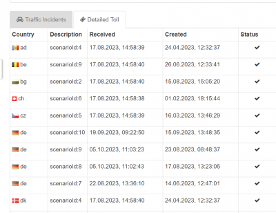

Re: New toll tarrifs for Germany (dec2023 / july2024)
Posted: Thu Oct 05, 2023 1:09 pm
Tschacka!
Check our xserver blog post : Detailed Toll Forecast Germany is online for on premise installations with the 2023.2H map ...
your local CUS will download the scenarios:
http://127.0.0.1:50000/dashboard/Default.htm#Administration/ContentUpdateStatus.htm#detailedToll
Check your local management console for updates.
