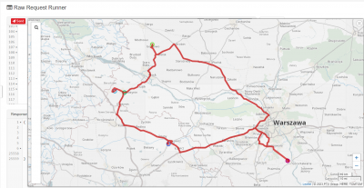

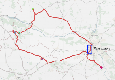

I use xRoute to calculate the route in Poland. The route is then displayed using the map. In some situations, the calculated route runs through roads where transit is prohibited, for example Warsaw (see attachment).
Current regulations say that entry to Warsaw is possible only for vehicles that make deliveries in Warsaw. Other vehicles must use different routes.
What should be done to take this scenario into account?
Below is an example query:
{"waypoints":[{"$type":"OnRoadWaypoint","location":{"coordinate":{"x":21.184751,"y":51.989141}}},{"$type":"OnRoadWaypoint","location":{"coordinate":{"x":21.184751,"y":51.989141}}},{"$type":"OnRoadWaypoint","location":{"coordinate":{"x":19.763054,"y":52.736877}}},{"$type":"OnRoadWaypoint","location":{"coordinate":{"x":19.474281,"y":52.429691}}},{"$type":"OnRoadWaypoint","location":{"coordinate":{"x":19.474281,"y":52.429691}}},{"$type":"OnRoadWaypoint","location":{"coordinate":{"x":19.37035,"y":52.438217}}},{"$type":"OnRoadWaypoint","location":{"coordinate":{"x":19.934122,"y":52.09812}}},{"$type":"OnRoadWaypoint","location":{"coordinate":{"x":21.184751,"y":51.989141}}},{"$type":"OnRoadWaypoint","location":{"coordinate":{"x":21.184751,"y":51.989141}}},{"$type":"OnRoadWaypoint","location":{"coordinate":{"x":21.184751,"y":51.989141}}}],"resultFields":{"polyline":true},"routeOptions":{"polylineOptions":{"elevations":true}},"requestProfile":{"routingProfile":{"searchSpace":{"heuristicAggressiveness":0},"course":{"violations":{"enabled":false}}},"featureLayerProfile":{"themes":[{"enabled":true,"id":"PTV_TruckAttributes"}]},"vehicleProfile":{"weight":{"emptyWeight":36000,"loadWeight":0,"totalPermittedWeight":36000},"legalCondition":{"isDelivery":false,"isEmergency":false},"dimensions":{"height":400,"length":1875,"width":254.99999999999997},"load":{"loadType":"GOODS"},"axle":{"numberOfAxles":"4"},"engine":{"emissionStandardEU":"EURO_5","engineType":"COMBUSTION","fuelType":"DIESEL"}}}}

Hello Szymon,
your request triggers the following topics in my mind:
  • VehicleProfile.LegalCondition.IsDelivery: your sample request disabled this flag. By enabling this your vehicle is declared to be allowed to use segments with delivery restrictions.
    isDelivery=true  :  successful routing
    A side effect: by setting this value to true the vehicle is allowed to drive through ANY isDeliveryOnly area as there's no distinct ID that separates two different areas from each other. This mechanism may therefore cause issues when you are not allowed to drive through area B but did set "isDelivery=true" to pass through area A.

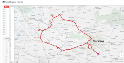

  • isDelivery=false: may cause issues (errors) if an involved waypoint is located in a delivery only area.
  • com.ptvgroup.xserver.routingprofile.Violations.enabled=true : this will allow the router to use segments which are violating constraints (TruckAttributes, RestrictionZones...). Any constrain, not only delivery. If a waypoint is located in a critical area it might be necessary to allow violations to reach it at all.
    violations.enabled = true
      "$type": "RouteResponse",
      "distance": 426424,
      "travelTime": 34399.657,
      "trafficDelay": 0,
      "polyline": {
        "plain": {
          "$type": "Polyline",
          "polyline": [..
      "violated": true
  • com.ptvgroup.xserver.routingprofile.Violations.enabled=false: this may sometimes cause the engine to desperately try to find a valid path to the waypoint. And when I say desperately this means "poor performance may occur". This happens often with the metropolitan areas which are more and more covered with isDelivery flags.

Changing options in any combination does not produce different results. I get the same wrong result every time.
How can I get a result like the one you presented in your map screenshot?
