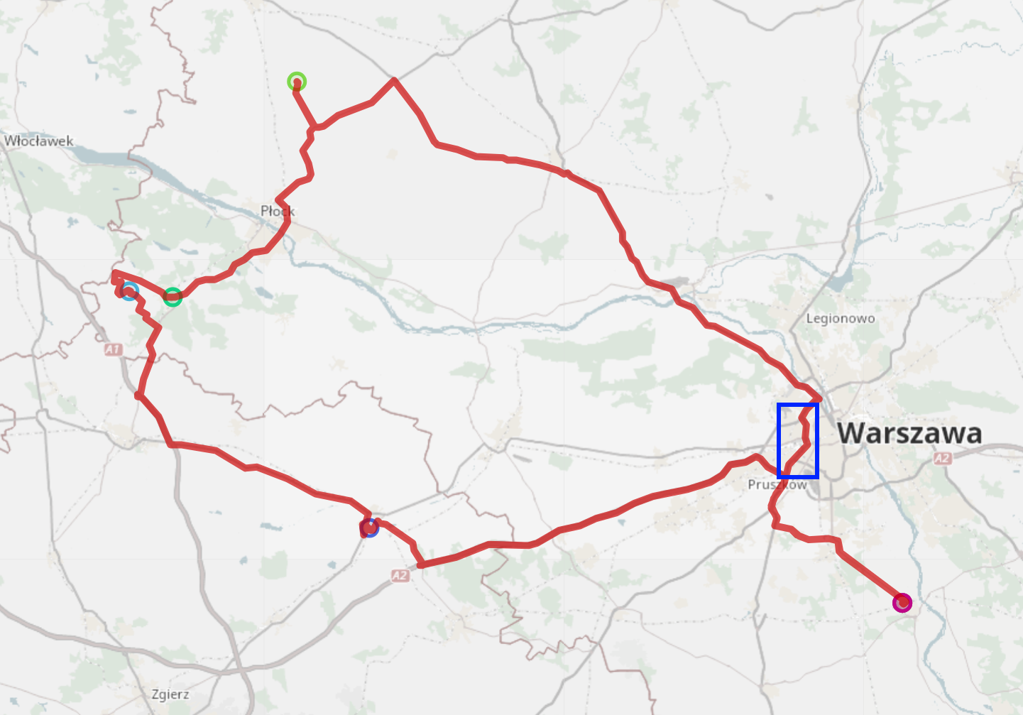

I use xRoute to calculate the route in Poland. The route is then displayed using the map. In some situations, the calculated route runs through roads where transit is prohibited, for example Warsaw (see attachment).
Current regulations say that entry to Warsaw is possible only for vehicles that make deliveries in Warsaw. Other vehicles must use different routes.
What should be done to take this scenario into account?

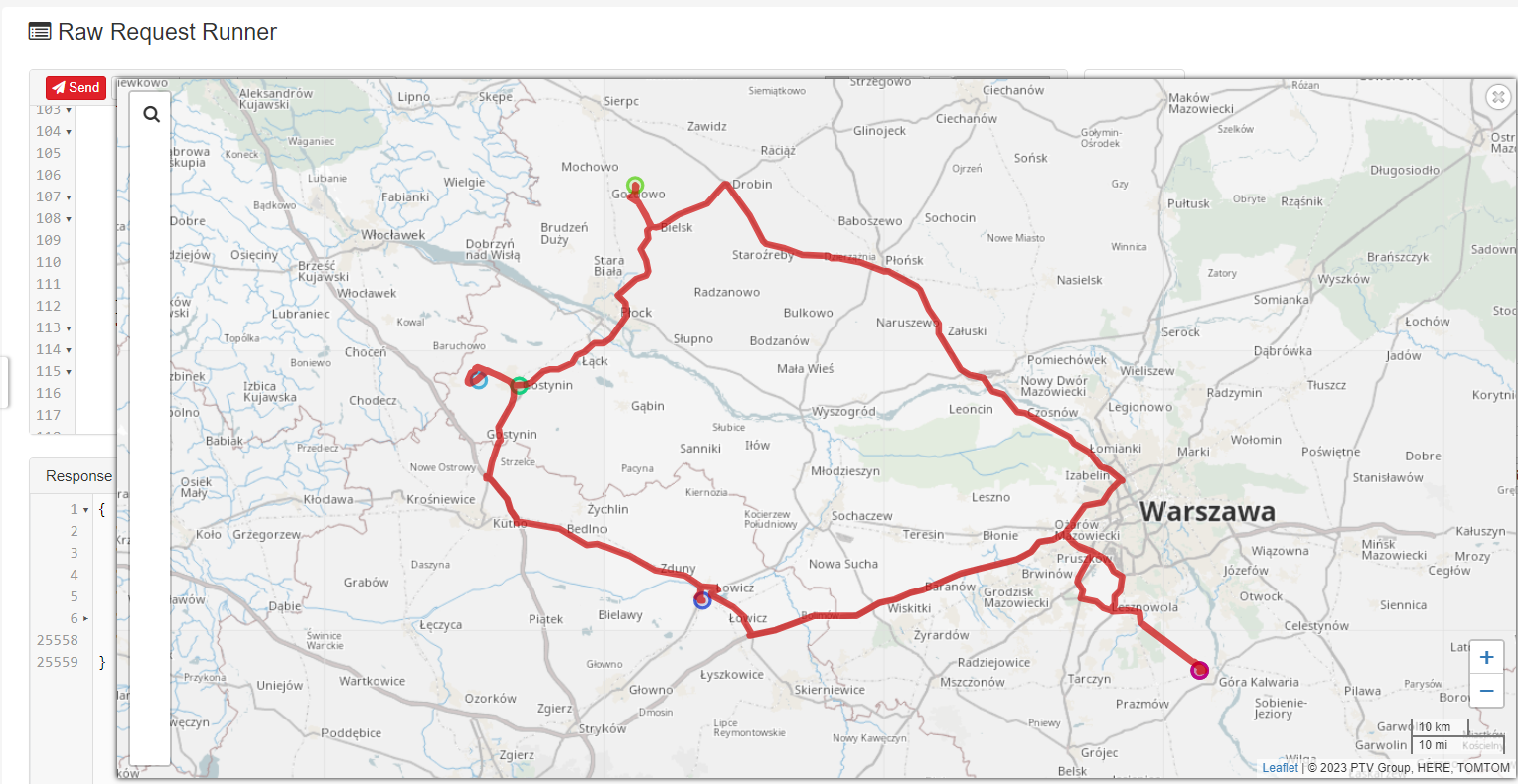

  • VehicleProfile.LegalCondition.IsDelivery: your sample request disabled this flag. By enabling this your vehicle is declared to be allowed to use segments with delivery restrictions.
    isDelivery=true  :  successful routing
    A side effect: by setting this value to true the vehicle is allowed to drive through ANY isDeliveryOnly area as there's no distinct ID that separates two different areas from each other. This mechanism may therefore cause issues when you are not allowed to drive through area B but did set "isDelivery=true" to pass through area A.

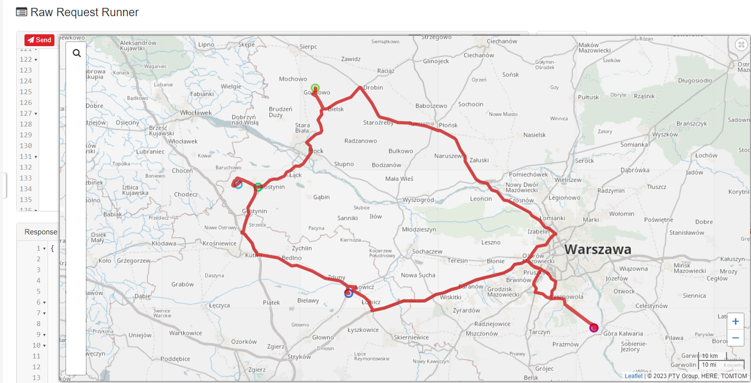

  • com.ptvgroup.xserver.routingprofile.Violations.enabled=true : this will allow the router to use segments which are violating constraints (TruckAttributes, RestrictionZones...). Any constrain, not only delivery. If a waypoint is located in a critical area it might be necessary to allow violations to reach it at all.
    violations.enabled = true
      "$type": "RouteResponse",
      "distance": 426424,
      "travelTime": 34399.657,
      "trafficDelay": 0,
      "polyline": {
        "plain": {
          "$type": "Polyline",
          "polyline": [..
      "violated": true

Changing options in any combination does not produce different results. I get the same wrong result every time.
How can I get a result like the one you presented in your map screenshot?

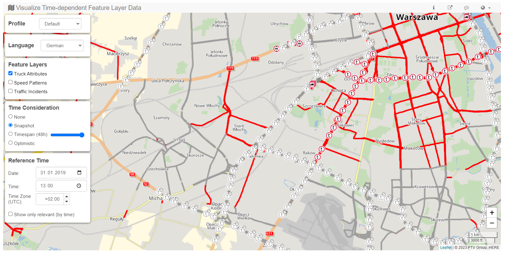

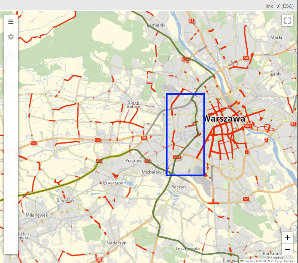

We identified at least the missing TimeConsideration as a cause for the issues: there are many, many time based truck attributes in the area
Play with this showcase to evaluate the coverage of such data!
Warszawa and it's many time dependent truck attributes
