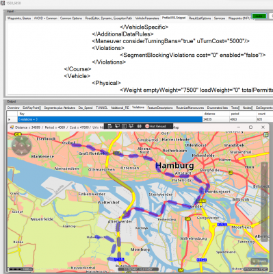

How to avoid: the Elbtunnel (based on xroute1, tunnel restriction code)
Posted: Tue Aug 08, 2023 8:21 am
I've been asked how to consider the Elbtunnel in Hamburg in terms of "tunnel restriction codes" in xRoute1.
Here's an example - check this snippet:
<Profile>
<GlobalSettings enableTimeDependency="true" enableVehicleDependency="true"/>
<Themes>
<Theme id="PTV_TruckAttributes" enabled="true" priorityLevel="0"/>
</Themes>
</FeatureLayer>
<Course distanceTimeWeighting="80" enforceShortestRoute="false">
<BasicDataRules>
<Toll extraTollMalus="0" tollMalus="0" vignetteMalus="0"/>
</BasicDataRules>
<AdditionalDataRules enabled="true" />
<Violations>
<SegmentBlockingViolations cost="0" enabled="true"/>
</Violations>
</Course>
<Vehicle>
<Physical>
<Weight emptyWeight="7500" loadWeight="0" totalPermittedWeight="15000"/>
<Dimension height="250" heightAboveFrontAxle="80" length="1200" width="220"/>
</Physical>
<Load hazardousGoodsType="NONE" loadType="GOODS" tunnelRestrictionCode="B"/>
</Vehicle>
</Routing>
</Profile>

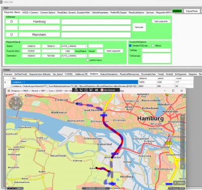

- Violations allowed - penalty = 0
- Violations forbidden

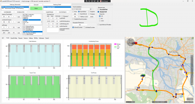

- And here's an exanmple for xRoute2. I Iterated over 7 days, hourly routing start

ok, looks like we made it very challenging when it comes to proper parameters in the profile... here's what you should set in a proper manner:
1. Enable the FeatureLayer id="PTV_TruckAttributes" to consider the legal restrictions
2. Enable TimeDependency: @FeatureLayer.GLobalSettings.enableTimeDependency
3. Enable Routing.Course.AdditionalDataRules
4. VehicleSpecific : set it to false
5. Vehicle.Load--> tunnelRestrictionCode = "whatever you want"...
6. RoutingOption.START_TIME
<Profile>
<Themes>
</Themes>

Posted: Wed Aug 16, 2023 9:59 am
wow - just made another test with xServer2 and identified this important effect.
Officially the Elbtunnel is labeled as
- 05:00-23:00 : E
- otherwise: C
Now from a legal perspective the tunnel is blocked for B-vehicles. No matter what time it is.
From a technical perspective you have to apply a time consideration - otherwise the time dependent TruckATtributes aren't considered.
Pirates be warned!

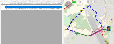

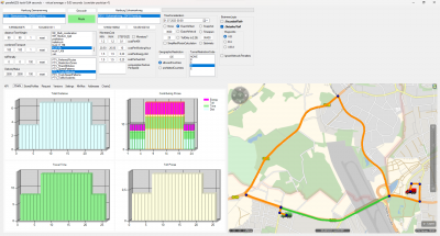

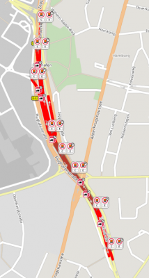

As a reaction to this thread my attention was drawn to the
Krohnstiegtunnel in Hamburg which is also regulated via time dependent restrictions.
The image shows 25 different start times and refers to a vehicle with tunnel code D.
During the "night time" (15:00-06:00) the vehicle takes the tunnel.
During the daytime (06:00:15:00) a detour applies.
- Krohnstiegtunnel in Hamburg (single routes)
Last but not least there are further similar restrictions near the Hamburg airport.
- Hamburg airport
Thanks to Andre for the hint!
