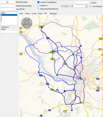

I've been asked how to consider the Elbtunnel in Hamburg in terms of "tunnel restriction codes" in xRoute1.
Here's an example - check this snippet:
<Profile>
		<GlobalSettings enableTimeDependency="true" enableVehicleDependency="true"/>
		<Themes>
			<Theme id="PTV_TruckAttributes" enabled="true" priorityLevel="0"/>
		</Themes>
	</FeatureLayer>
		<Course distanceTimeWeighting="80" enforceShortestRoute="false">
			<BasicDataRules>
				<Toll extraTollMalus="0" tollMalus="0" vignetteMalus="0"/>
			</BasicDataRules>
			<AdditionalDataRules enabled="true" />
			<Violations>
				<SegmentBlockingViolations cost="0" enabled="true"/>
			</Violations>
		</Course>
		<Vehicle>
			<Physical>
				<Weight emptyWeight="7500" loadWeight="0" totalPermittedWeight="15000"/>
				<Dimension height="250" heightAboveFrontAxle="80" length="1200" width="220"/>
			</Physical>
			<Load hazardousGoodsType="NONE" loadType="GOODS" tunnelRestrictionCode="B"/>
		</Vehicle>
	</Routing>
</Profile>

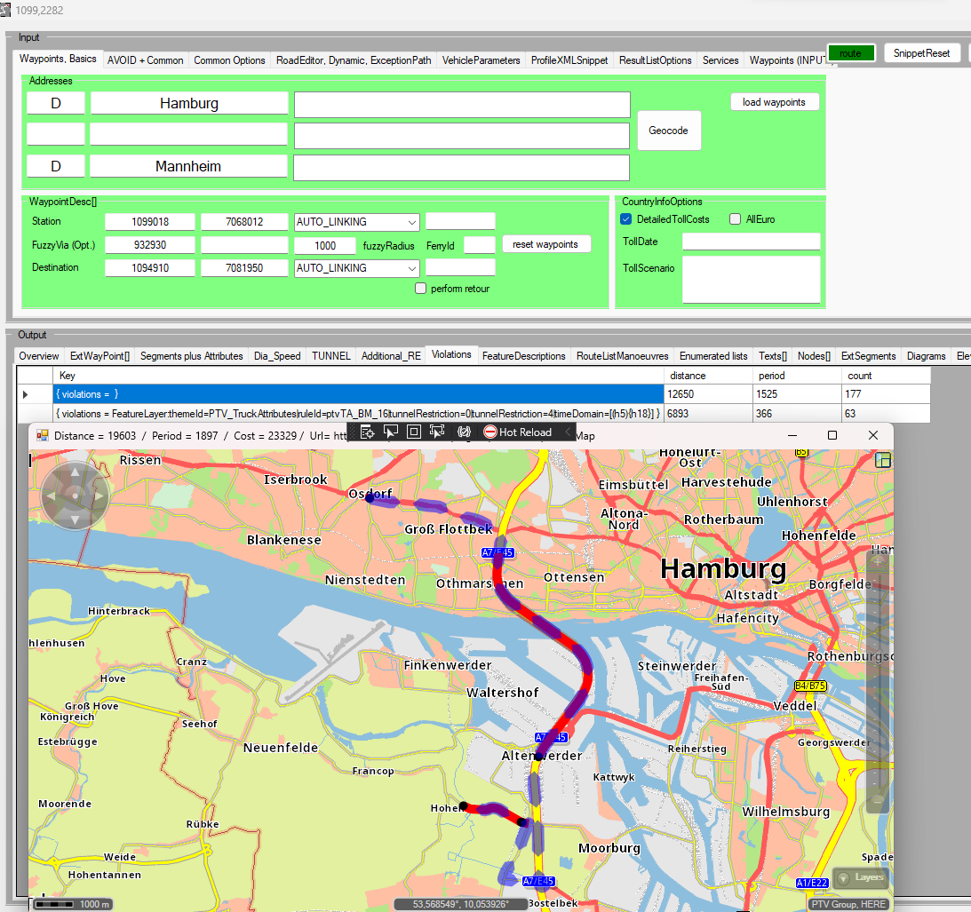

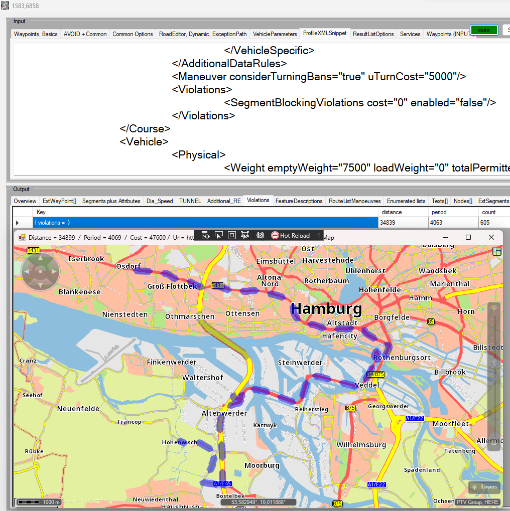

Violations allowed - penalty = 0
Violations forbidden

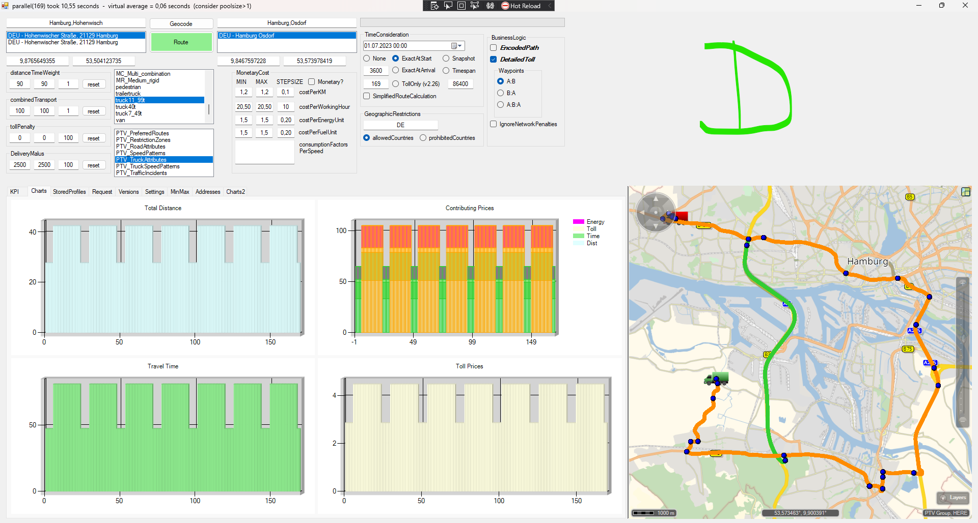

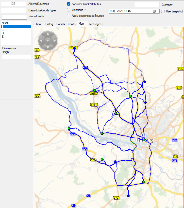

And here's an exanmple for xRoute2. I Iterated over 7 days, hourly routing start

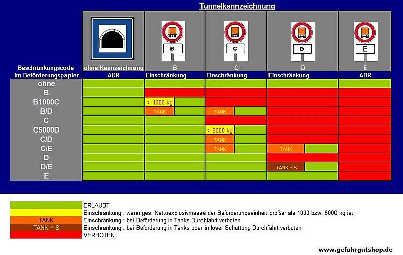

As i personally was rather confused about the codes and their meaning, this site is helpful:
Link to gefahrgutshop.de
So if i transport a product with tunnelcode E, i can drive through the elbtunnel if its not between 23-5 o'clock
as the restriction is of code C then.
Posts: 3010
Re: How to avoid: the Elbtunnel (based on xroute1, tunnel restriction code)
Hello Stefan,
thanks for the Link - you've been too quick for me: I was just preparing such a diagram ;-)

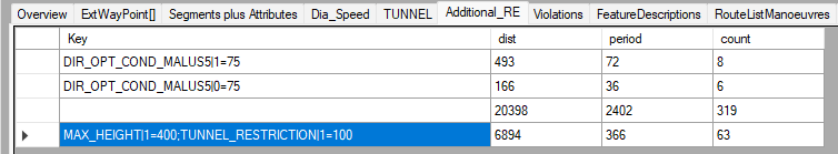

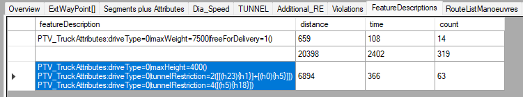

wow - just made another test with xServer2 and identified this important effect.
Officially the Elbtunnel is labeled as
  • 05:00-23:00 : E
  • otherwise: C
Now from a legal perspective the tunnel is blocked for B-vehicles. No matter what time it is.
From a technical perspective you have to apply a time consideration - otherwise the time dependent TruckATtributes aren't considered.
Pirates be warned!
5:00-23:00 : category E, <br />outside that timeframe C
Vehicle is &quot;tunnel-B&quot;, no time consideration mode activated (use snapshot==false) but the Tunnel is used: which is not correct
Vehicle is "tunnel-B", no time consideration mode activated (use snapshot==false) but the Tunnel is used: which is not correct

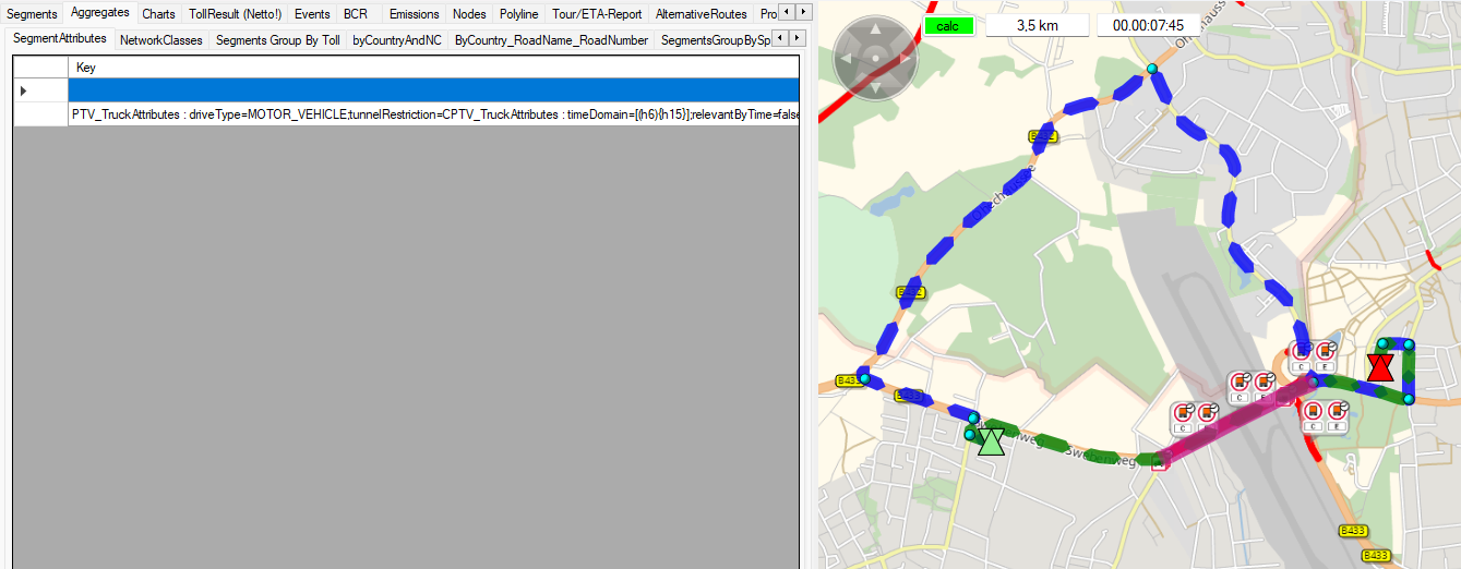

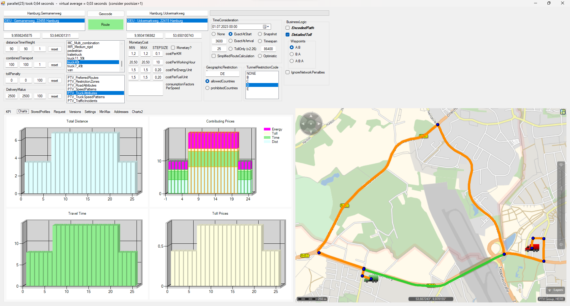

As a reaction to this thread my attention was drawn to the Krohnstiegtunnel in Hamburg which is also regulated via time dependent restrictions.
The image shows 25 different start times and refers to a vehicle with tunnel code D.
During the "night time" (15:00-06:00) the vehicle takes the tunnel.
During the daytime (06:00:15:00) a detour applies.
Krohnstiegtunnel in Hamburg (single routes)

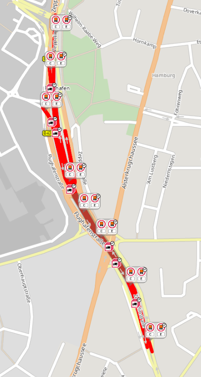

Last but not least there are further similar restrictions near the Hamburg airport.
Hamburg airport
Hamburg airport
Thanks to Andre for the hint!
