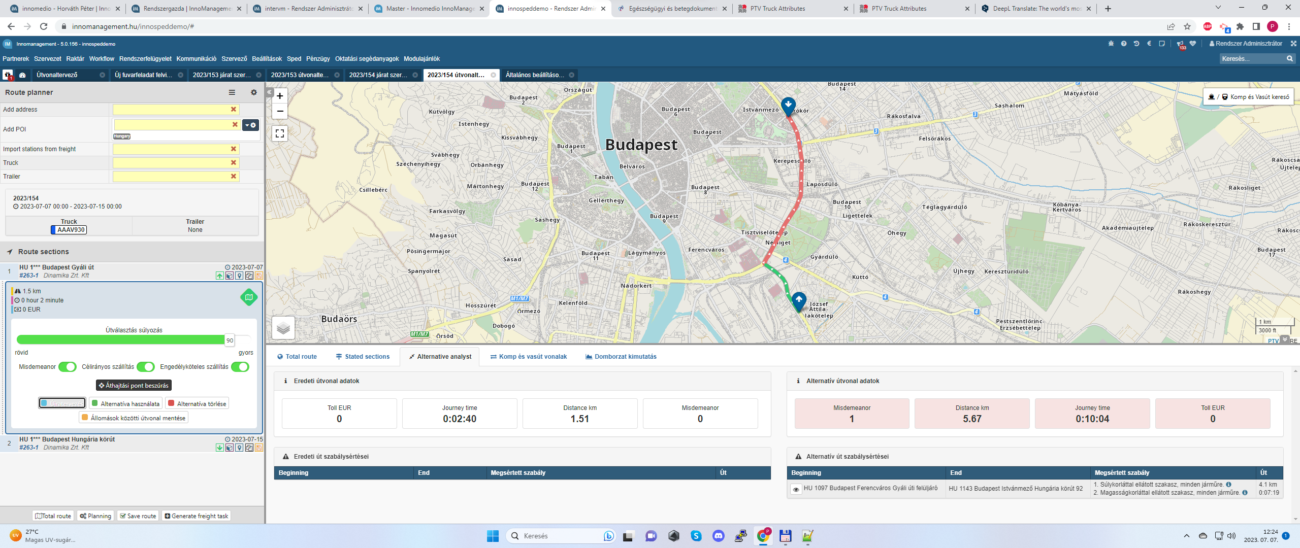

I've created an example route for this one:
HU 1*** Budapest Gyáli út
HU 1*** Budapest Hungária körút
See the attached picture.
The red lined segment is free to used with and extra permit.
In this case, I can only get a valid route from the engine, If I allow all violations. In that case the engine say that Hungaria körút has a 12000 kg max weight limit, which is actually true, but I you buy the extra license, than you can go to that road.

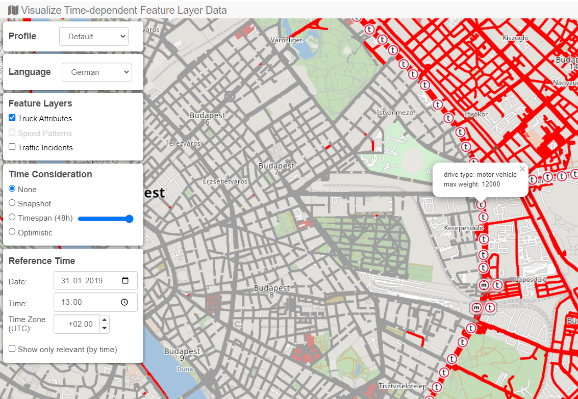

here's some feedback from our data department (translated by me):
Sounds like this isn't a toll topic but an extra license a company is supposed to request and to pay if a truck exceeds the 12t threshold.
According to the description this value is part of the PTV_TruckAttributes as a regular "weight restriction".
This does not cover the requirement properly but that's the state of the software and data right now.
the 12t weight restriction is part of the truck attributes layer
