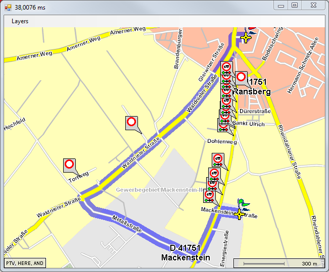

The following routing screenshots have been made with TRUCK profiles...
If the route is calculated against the restriction we are allowed to use the segments.
Trying to drive in the direction of the blocking is not allowed and so we take a detour.

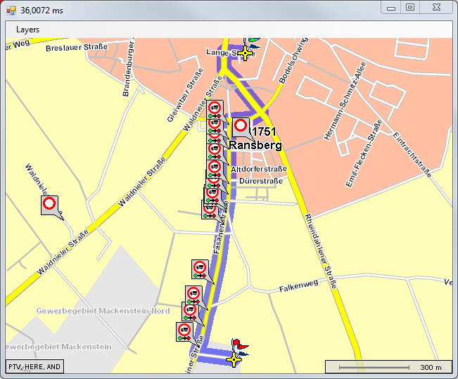

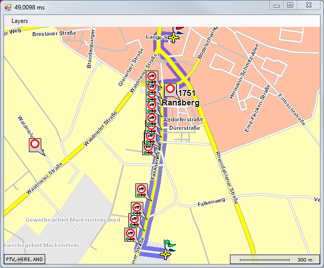

Driving from south to north by car doesn't require a detour as the restriction is for trucks only - even in case of "in driving direction".

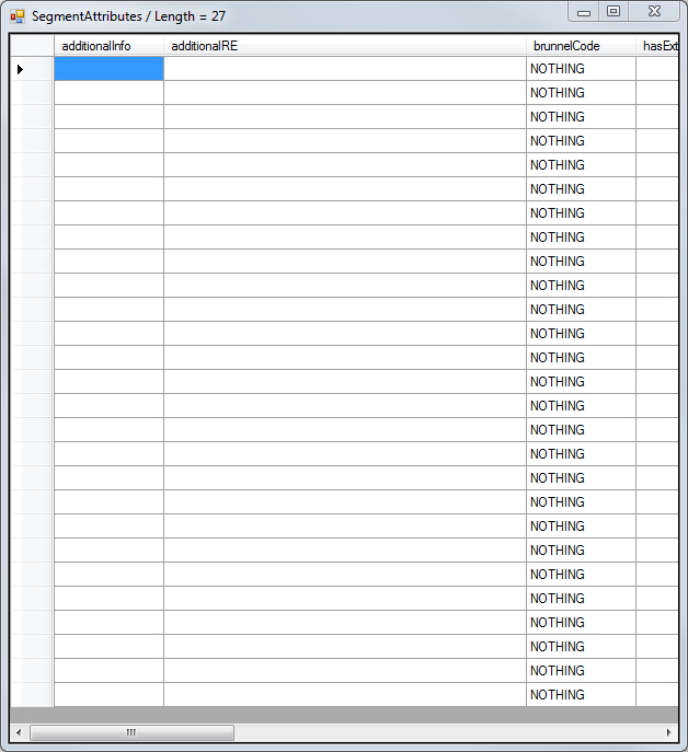

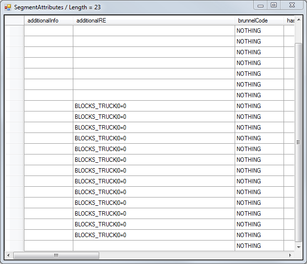

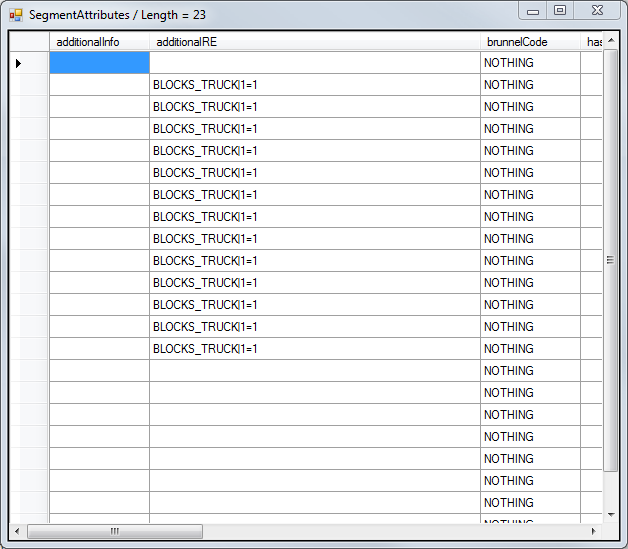

PS
ATTRIBUTES north to south
SOUTH to NORTH attributes truck
