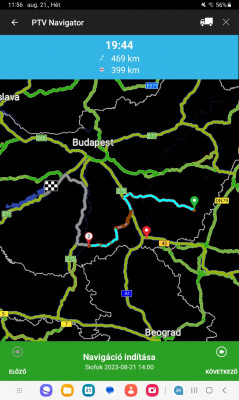

We attempted to implement the REROUTEATTRACTIONFACTOR parameter into the .BCR file, but encountered a new problem we cannot resolve.
When we load the .BCR into the Navigator, the app fails to generate a route from the driver's position.
In our example, this position corresponds to an address in Szeged (46.261436, 20.128069).
We adjusted the REROUTEATTRACTIONFACTOR to various values (e.g., 100 and 40), but there was no change.
The header of the .BCR looks like this:

Do you have any insights or suggestions on what might need modification to resolve this?
Interestingly, when the [Station2Segmentcenters] section is removed from the .BCR, the Navigator generates a route to the second station.
I have attached a screenshot for your reference.
Thank you in advance!
Peter
