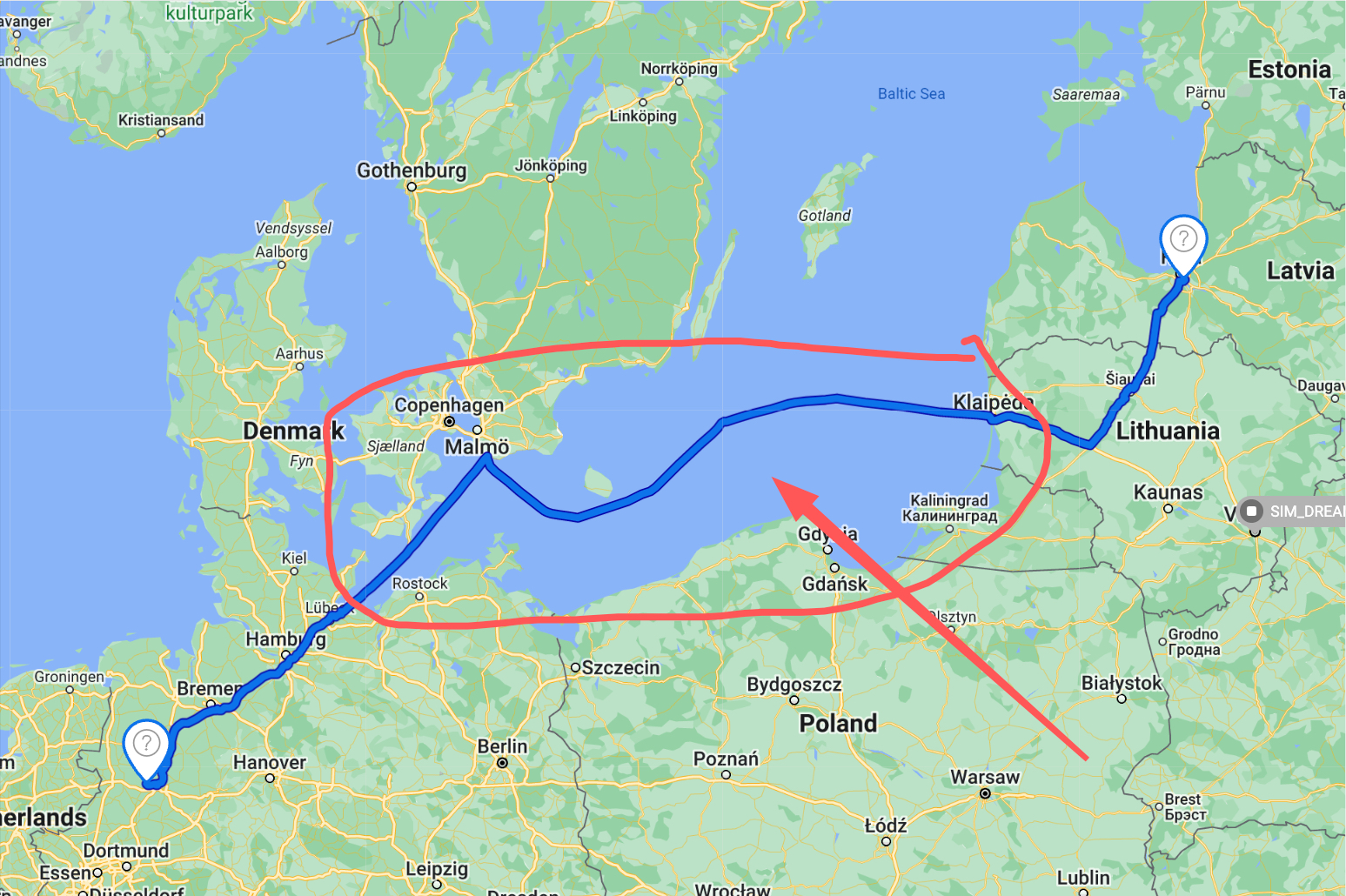

Could you pls help us. We need to disable all Ferry transportation so PTV xRouteServer would not calculate route through water. Thx!

That was easy:
xServer2 allows you to put a spell on the ferries by using the parameter com.ptvgroup.xserver.routingprofile.CombinedTransport
  "requestProfile":{
    "routingProfile":{
      "course":{
        "combinedTransport":{
          "boatPenalty": 2501
  "waypoints": [
      "$type": "OffRoadWaypoint",
      "location": {
        "offRoadCoordinate": {
          "x": 8.045559851,
          "y": 52.271949744
      "location": {
          "x": 24.114870021,
          "y": 56.945980094
  "resultFields": {
    "polyline": true

Thanks for a lightning fast reply Bernd. It worked! ;)
