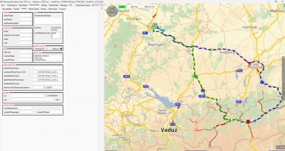

just a sample for the new v2.28 feature called "Quell- und Zielverkehr" (aka Transit) - your feedback is appreciated!
Depending on where your pickup and delivery takes place you might be granted access to some roads such as
  • specific highways or parts of them in Austria (e.g. some sections of the A12 near Innsbruck)
We use the feature layer PTV_RestrictionZones to handle this.
Three routes starting in Munich. The destinations are <br />Innsbruck (within the transit zone, therefore allowed to use the A12), Vipiteno and Bolzano (both outside the transit zone, therefore large detours apply).

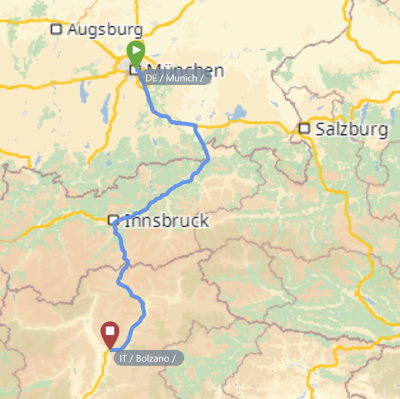

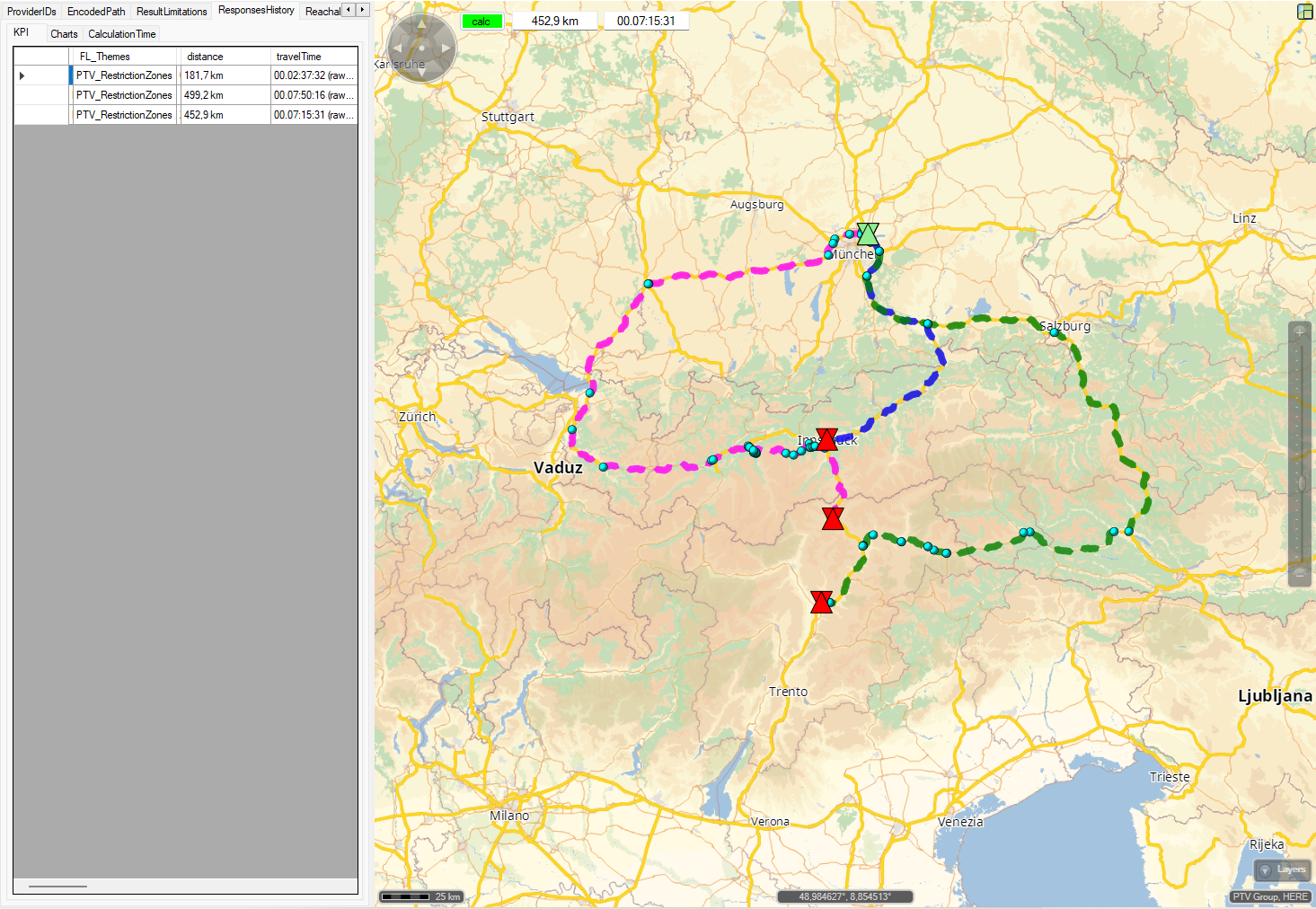

thank you for your provided example.
I tested it with the Europe map version 2023.2H, xServer 2.30 on premises, routing profile "truck40t", enabled PTV_RestrictionZones and PTV_TruckAttributes.
Start is Munich, end is Bolzano:
However, it ignores the restrictions and uses a different route (instead of first routing to Salzburg).
Did I miss something?
Posts: 2892
Re: v2.28: Quell- und Zielverkehr in Austria
Hi Matthias,
I just spoke to Marko about this. From his perspective the trip from Munich to Innsbruck is correct.
This is because the screenshot I created in February was based on a different data condition and if I git Marko correct then we changed the road attributes of the A45 with the 2023.2H map.
Unfortunately the usage of that road is restricted for a specific blacklist of goods such as "different kinds of garbage" and you can't provide such details in the routing request.
I will create an internal bugtracking task to discuss this behaviour with someone from DEV (once he/she is back from vacation).

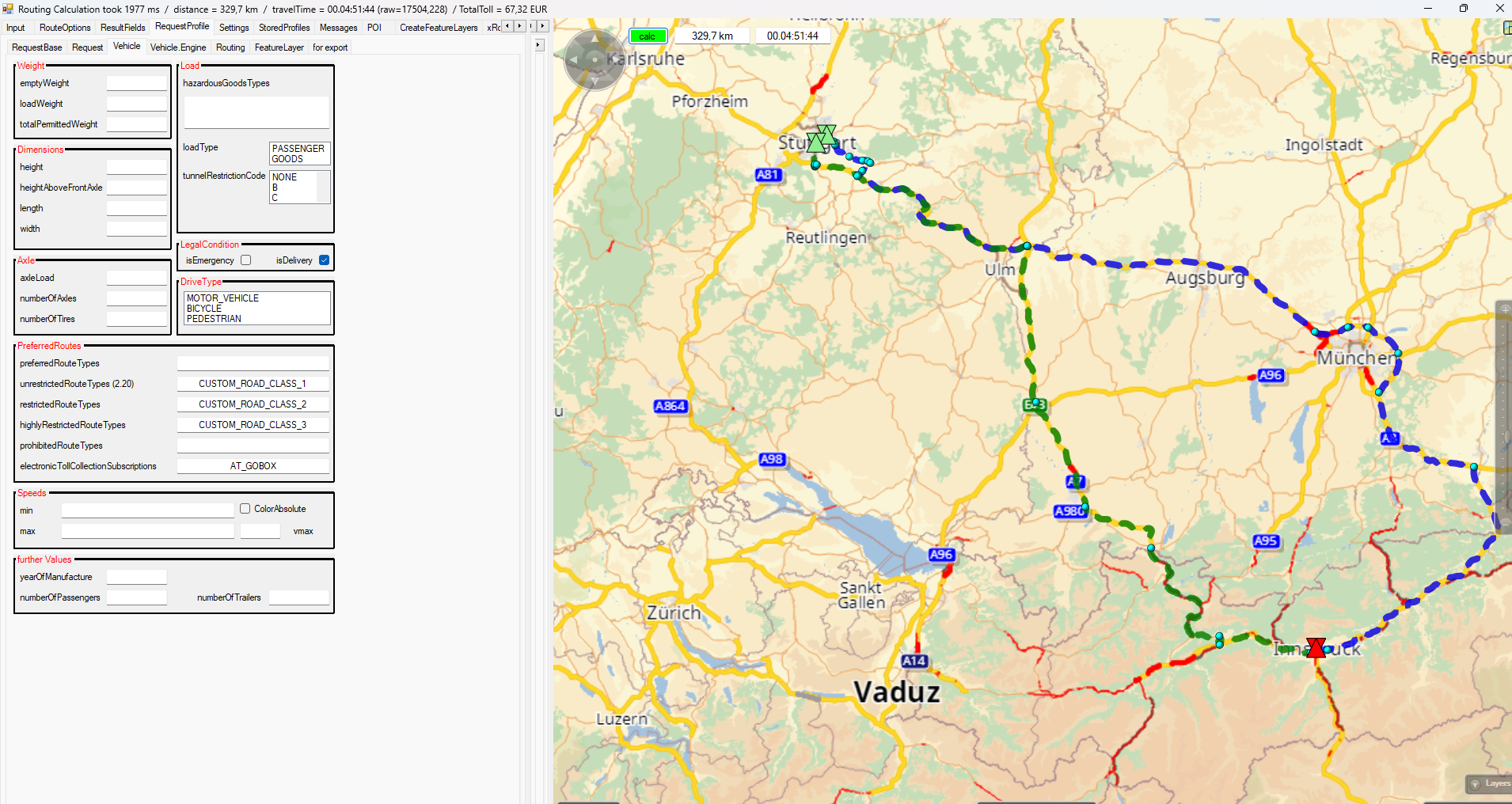

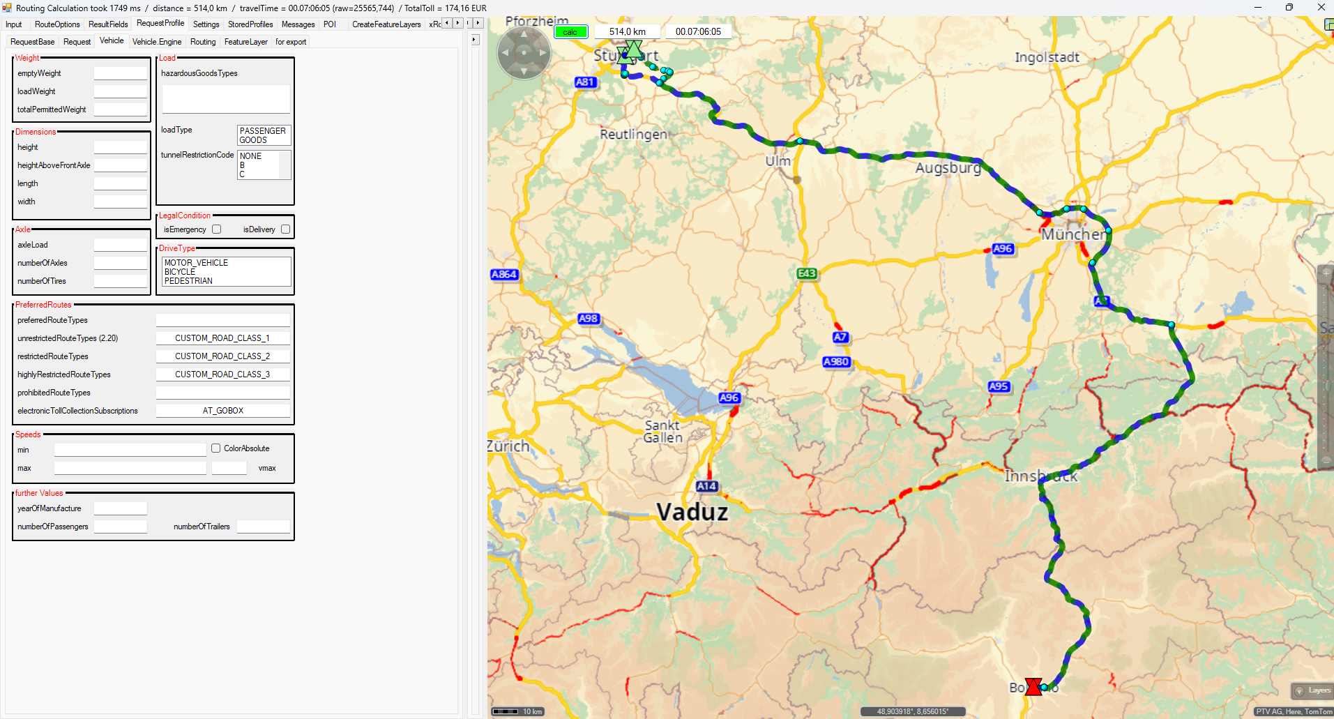

Stuttgart - Bolzano : no difference between isDelivery==true and isDelivery==false <br />This applies because the pickup/delivery happens completely outside the Quell- and Zielverkehr zones

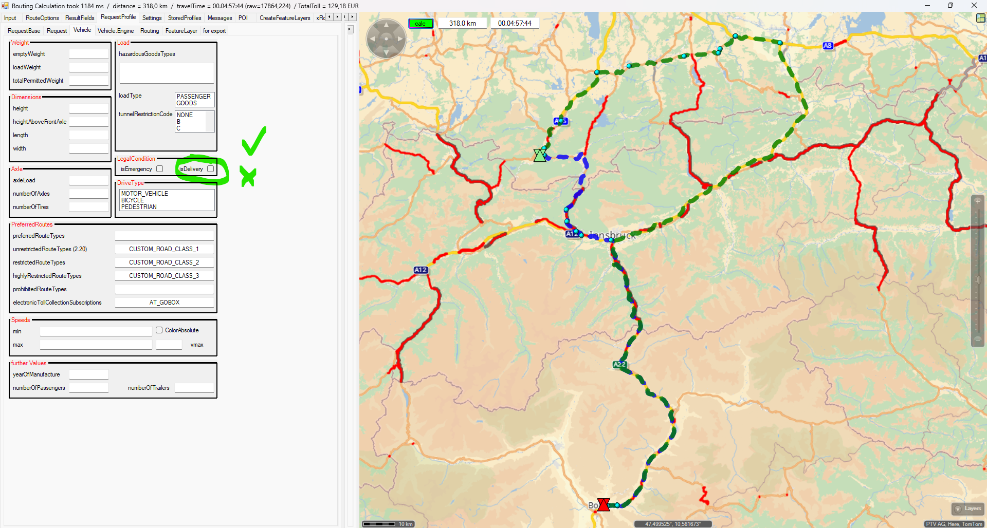

Garmisch - Bolzano : <br />if isDelivery==true the route takes a short path via the Fernpass. <br />if isDelivery==false the route takes a detour.<br />Because the pickup is inside te Quell- and Zielverkehr zone.
Stuttgart - Innsbruck:<br />if isDelivery==true the route takes a short path via the Fernpass. <br />if isDelivery==false the route takes a detour.<br />Because the delivery is inside te Quell- and Zielverkehr zone.
