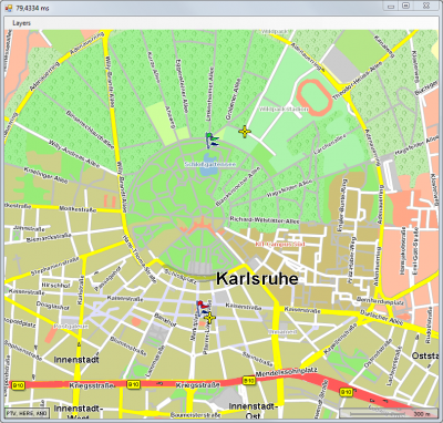

these days a customer asked me about some issues within routing. Some of his waypoints are locate far away from the regular street network and he wanted to know how to deal with this. So here are some basics of linking that should enable you to optimize your requests ;-)
The flags on this map show the input coordinates (green=start, red=destination) of a route. As the close environment of these coordinates is not allowed for the vehicle (e.g. because of pedestrian zone, tollroads forbidden, trucks forbidden...) we have to investigate which other segments within a given radius are allowed. In this plot we finally find the segments near the yellow crosses. Those are the closest segments that match our routing options  (malus values) and our vehicles properties.

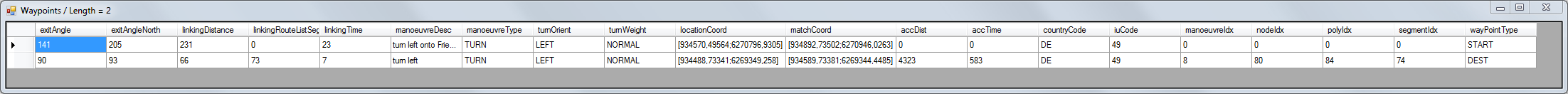

It is possible to request some details about this linking process. Just use the RoutingOption.GENERATE_EXTWAYPOINTS and the server returns info such as airline distance between Waypoint input coordinates and the linking points.
The output info for the Waypoints / Linking points

As you can see in the example one of the waypoints is located more than 200m away (linkingDistance). So this is why this reduction raises a well known linking error:

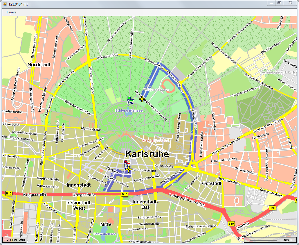

The default value for the search distance is 5000m. In most cases this is a sufficient distance. In the given scenario the route is successfully computed and looks like this:
The proper route
The proper route
The linking distance is just one out of several parameters that have impact on this scenario. Feel free to get back to us if you have some challenges dealing with such plots. And be aware that there is always a message behind a linking error - therefore do not increase the radius if it is important for you to recognize whether you are far of!
