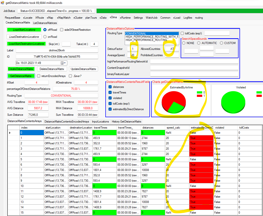

A sample 4x4 matrix output: the waypoints are in Germany but the allowedCountries are restriced to Austria. Therefore the routings performed a fallback to airline. WHich can be seen in the "estimatedByDirectDistance" column
