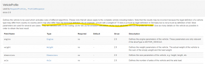

Another question about the axle load: will this be used within routing (xRoute 2, xDima 2) and HPR? in combination with TruckAttributes?
Here's what I would respond:
  • Well, these values are defaults, in fact. I wouldn't assume that each axle of a vehicle creates equal pressure on the road. But you can always override the values one by one if you don't feel comfortable with the defaults.
  • Yes, as mentioned in the VehicleProfile some properties of a vehicle may be used in combination with some of the usecases.
    Vehicle Properties taken from the documentation

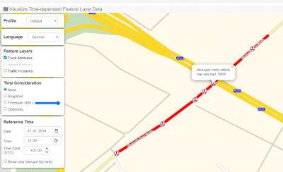

Here's an example of an axle based restriction (Kloppenheimer STraße between Mannheim and Heidelberg)
