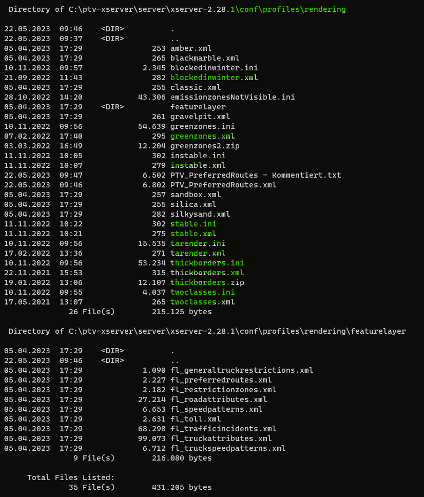

Meanwhile I found the cause for this issue on my local environment:
  • The error message was triggered by some profiles I created manually as copies of the existing profiles. As my "templates" (such as "amber.xml") were stored in /conf/profiles/rendering they refered to the required fl-files via
    parent="featurelayer/fl_*"
  • Solution: I moved my custom profiles into the same /rendering subfolder
Thanks to Heidi for the missing link!
dir /s *   (from within my rendering subfolder)
