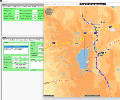

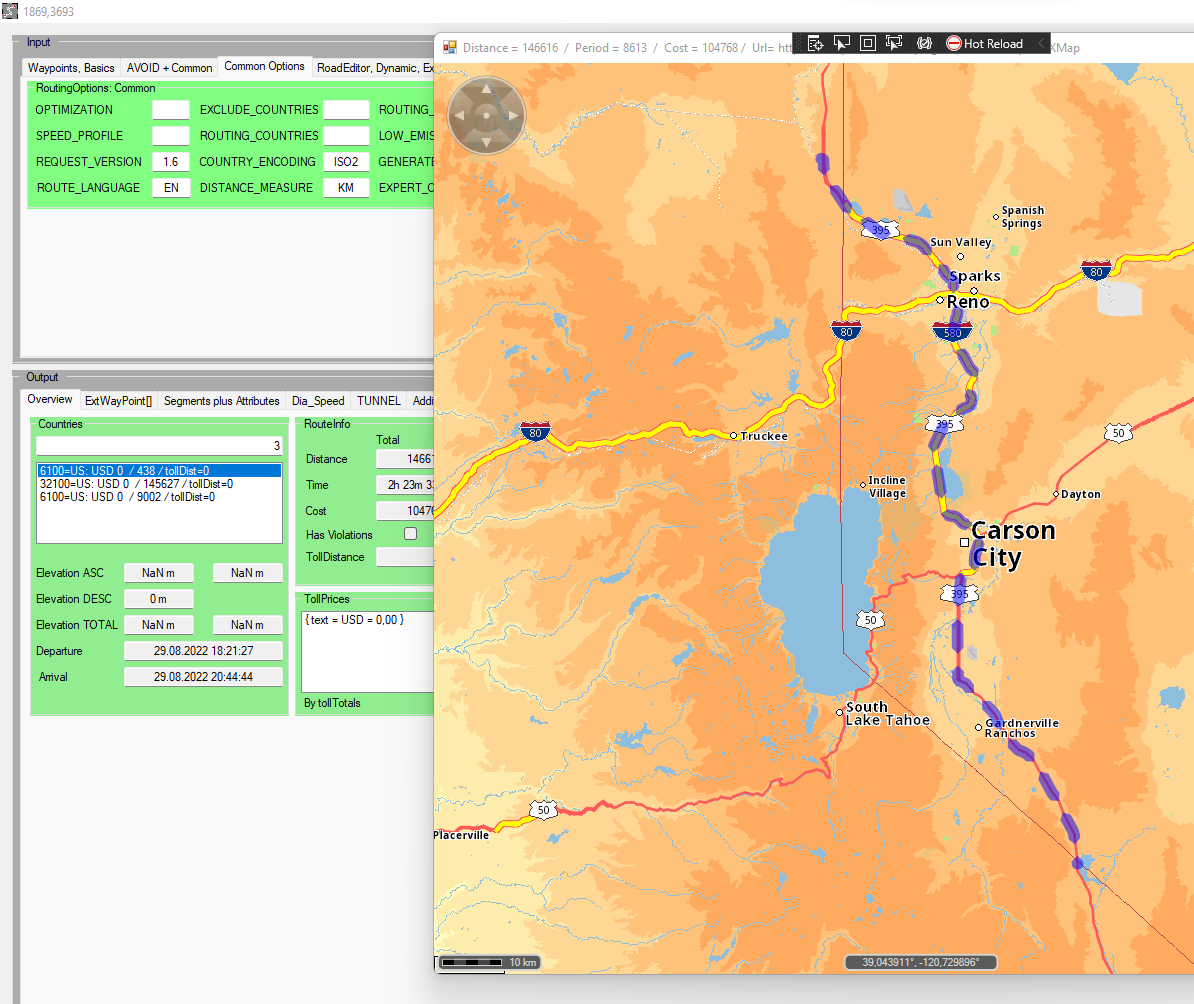

Here are some samples:
No restrictions applied - the route starts in California (6100), passes Nevada (32100) and ends in California (6100). Check the toll lists on the left bottom.

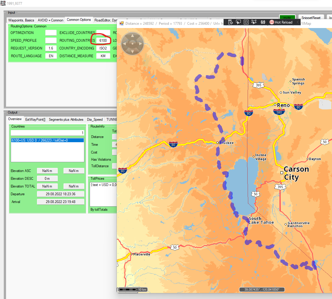

This setting restricts the route to be &quot;within California (6100)&quot;
This setting restricts the route to be "within California (6100)"

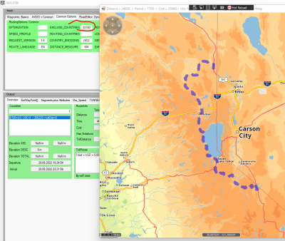

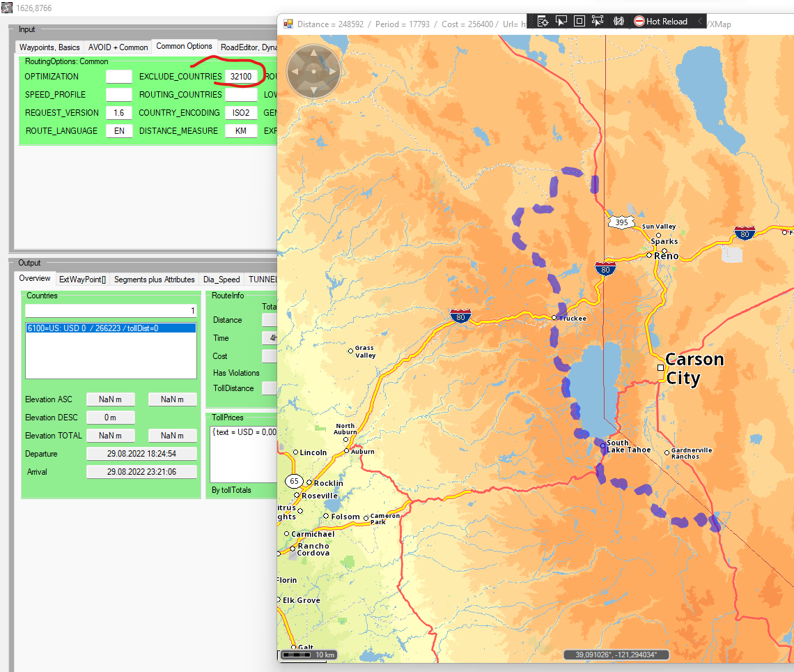

Now this one excludes Nevada (=32100) from the route.
