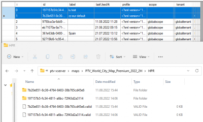

List of my local HPRs. The first two elements in the list are the ones stored below my map folder. The other graphs are placed below [server]/data/hpr
