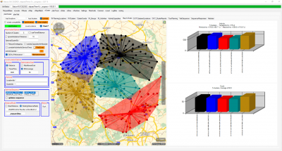

- In this next step I set considerActivitiesAsServiceTimes==TRUE and the optimal solution now considers both driving time and service time contribution as part of the target function. So we create a single tour structure within each cluster. Therefore the tocal activity (=traveltime) in a cluster with 10 customers is not 36'000 (10:00:00) but a value which is a little bit bigger, e.g. 46'975 = 13:02:55 (=10 hours service period + 3:02 for driving).
- Now in the fourth example I also activated the switch "useTravelDistance" which means that the target function balances not the travel TIME (upper case with tours between 11:01 and 14:44) but the travel DISTANCE of the estimated tours (between 11:00 and 11:46)

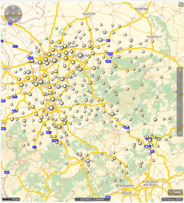

Now here's a more concrete example for clustering based on 300 sample customers:
- The sample positions (Germany)

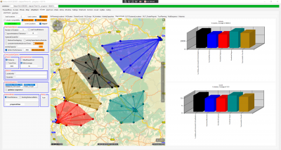

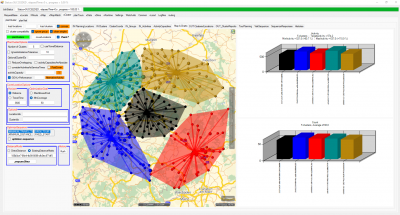

In the next step I computed two distance matrices with 0% and 80 weight between distance and time:
- The 0% dima (default profile)
- The 80% version of the dima
And finally I did the clustering based on these dima's which obviously produced different assignments:
- The cluster output based on the 0% dima
- The cluster output based on the 80% dima

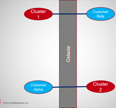

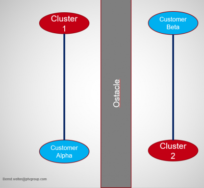

Here's also an academic example:
- Path over the mountain is short. If we don't care for the reduced driving speed (and the increased traveltime) the best assignment is shown here.
- But if we care about the traveltime (and distance doesn't matter) and the driving speed is fast within one of the two regions "east" and "west" the best assignment is the one displayed in this map.
