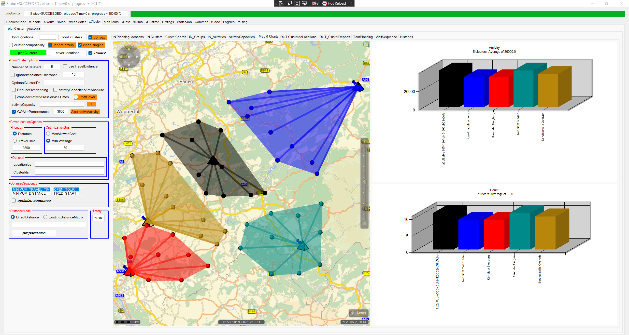

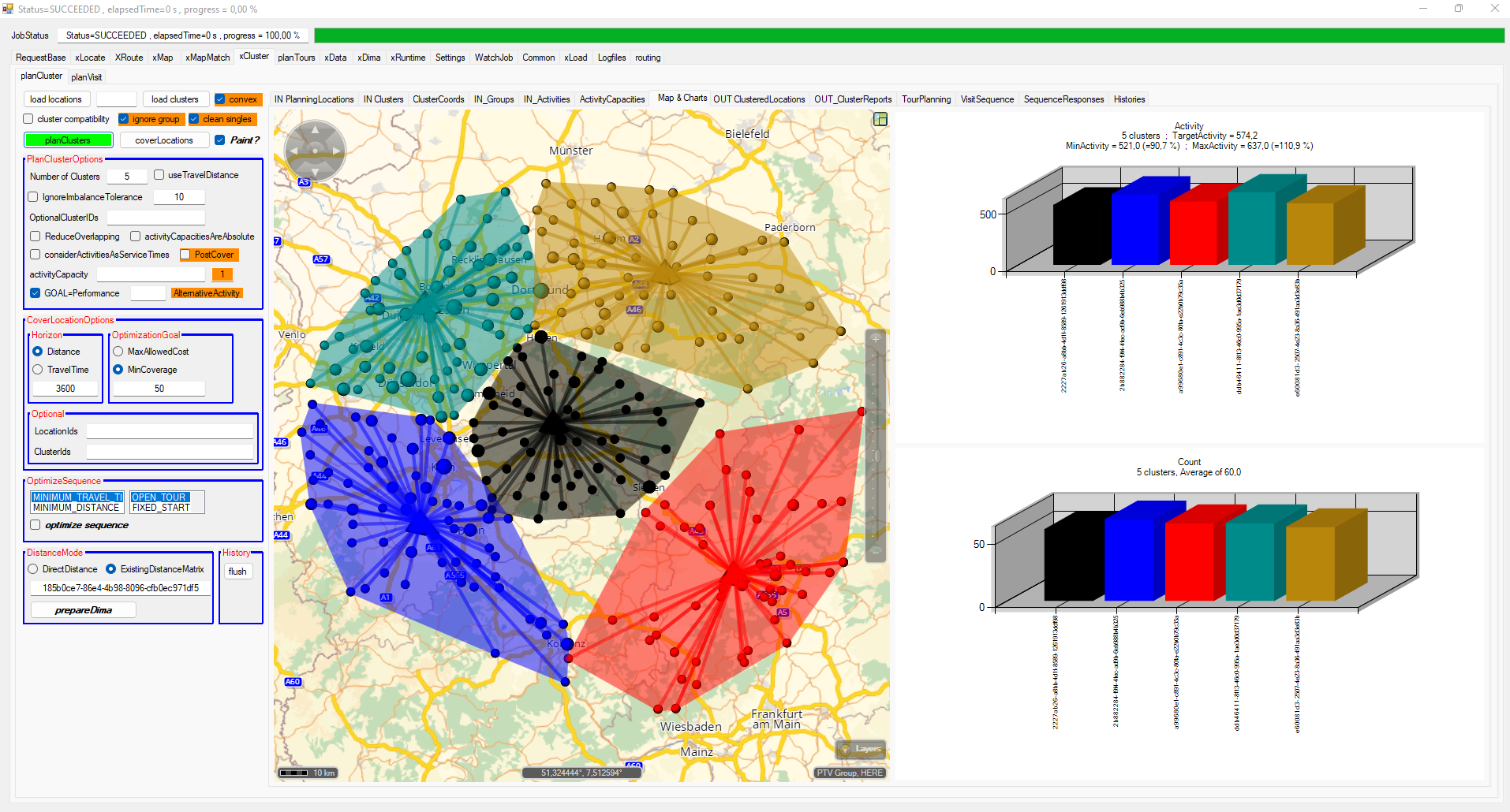

I prepared some screenshots - maybe they can help to get rid of the misunderstandings:
First lets start wir the basic scenario where I consider 50 customers/locations and 5 technicians/clusters. Furthermore each customer has an activity of 3600.

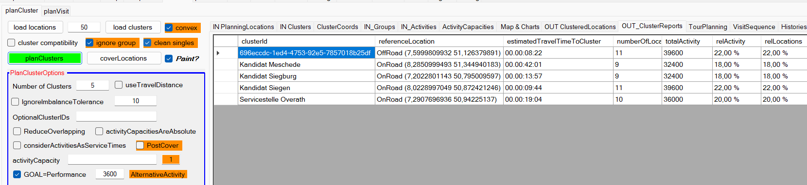

Now with considerActivitiesAsServiceTimes set to FALSE we simply treat the activities as pure double values and the expected perfect solution would be to have equal sum of activities for all customers within a cluster (10*3'600=36'000)

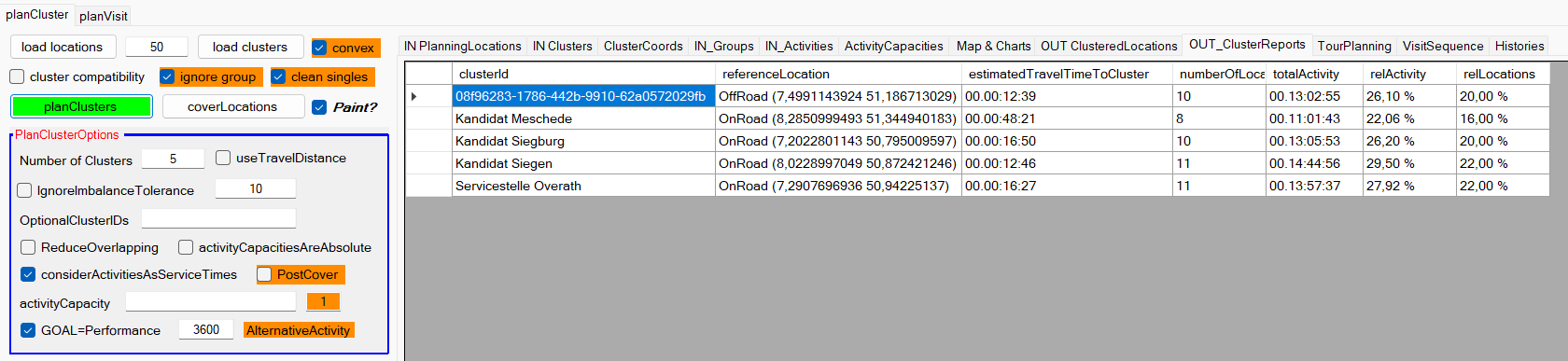

In this next step I set considerActivitiesAsServiceTimes==TRUE and the optimal solution now considers both driving time and service time contribution as part of the target function. So we create a single tour structure within each cluster. Therefore the tocal activity (=traveltime) in a cluster with 10 customers is not 36'000 (10:00:00) but a value which is a little bit bigger, e.g. 46'975 =  13:02:55 (=10 hours service period + 3:02 for driving).
Now in the fourth example I also activated the switch "useTravelDistance" which means that the target function balances not the travel TIME (upper case with tours between 11:01 and 14:44) but the travel DISTANCE of the estimated tours (between 11:00 and 11:46)
Does this answer the questions?
PS: I used a CAR based distance matrix for the 2-4 screenshot

Hello Prakash,

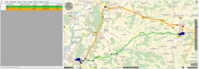

the difference between "useTravelDistance=true" and "useTraveldistance=false" is whether you prefer
  • The travel time
  • The travel distance

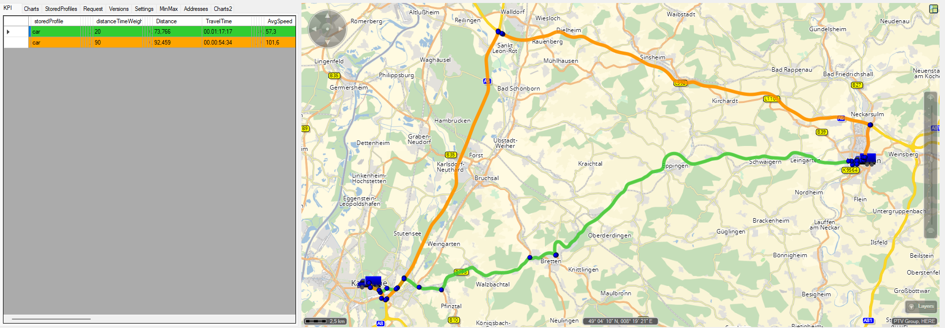

Sometimes the underlying geometries arre completely different. Here's a typical example for a single relation:
shortest track (green) is not necessarily the fastest one. While the green track ist 73km andn therefore much shorter than the orange one (93km) the traveltimes are flipped: the green track requires much longer (+20minutes).

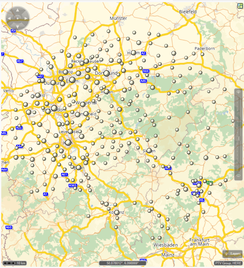

Now here's a more concrete example for clustering based on 300 sample customers:
The sample positions (Germany)

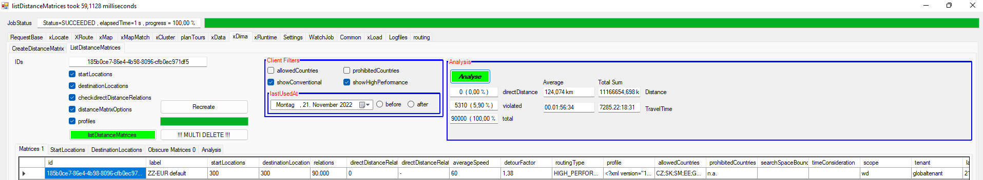

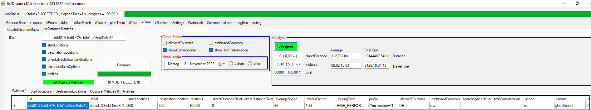

In the next step I computed two distance matrices with 0% and 80 weight between distance and time:
The 0% dima (default profile)
The 80% version of the dima

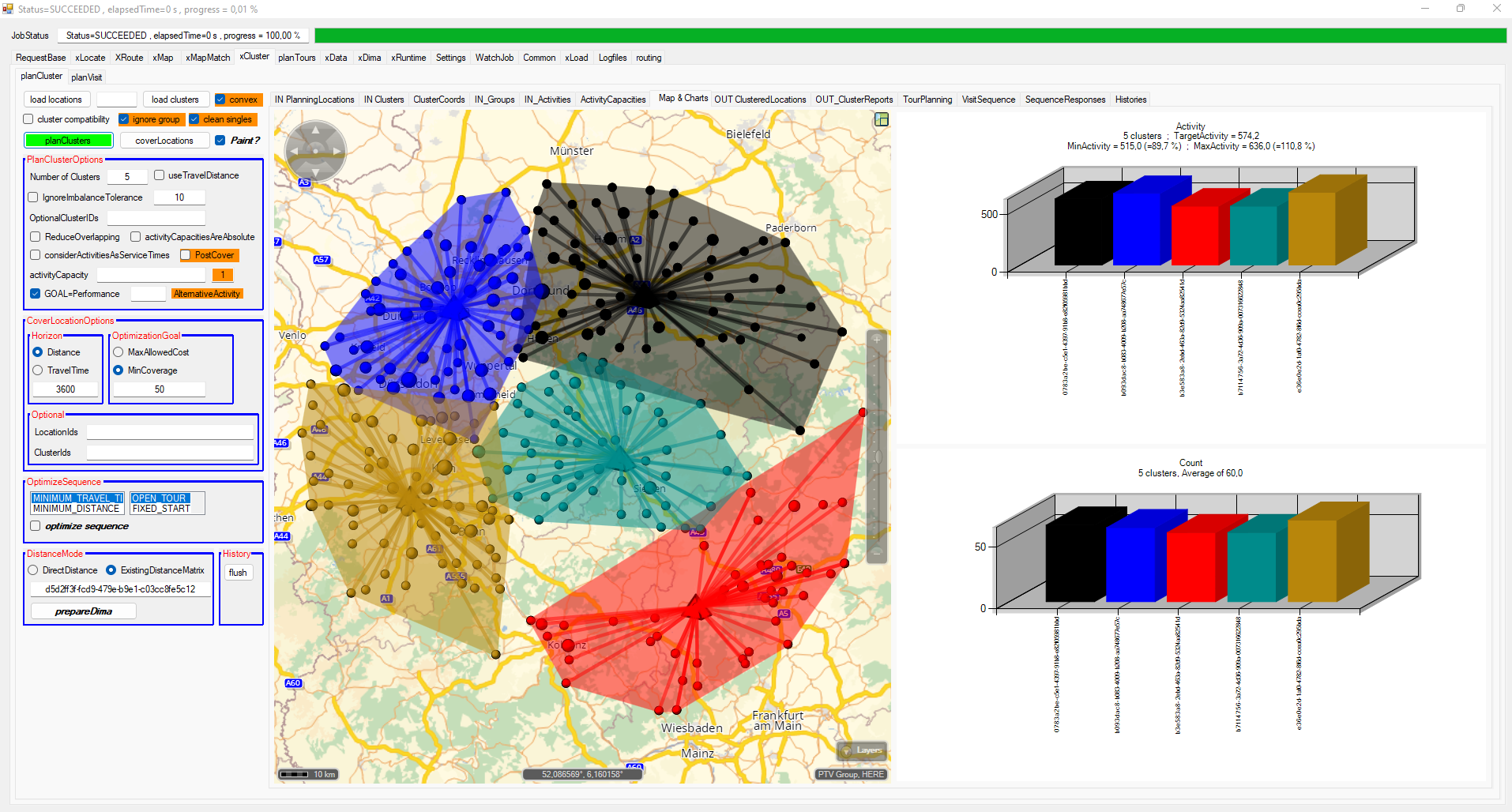

And finally I did the clustering based on these dima's which obviously produced different assignments:
The cluster output based on the 0% dima
The cluster output based on the 80% dima
Unfortunately there's no such thing as a "single KPI" that enables a user to gather the obvious distance as in my "single relation" sample above.
But nevertheless I hope you can see that there's an impact on the output.

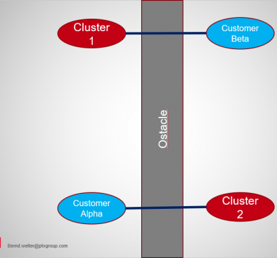

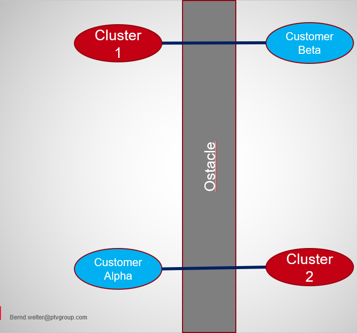

Here's also an academic example:
Path over the mountain is short. If we don't care for the reduced driving speed (and the increased traveltime) the best assignment is shown here.

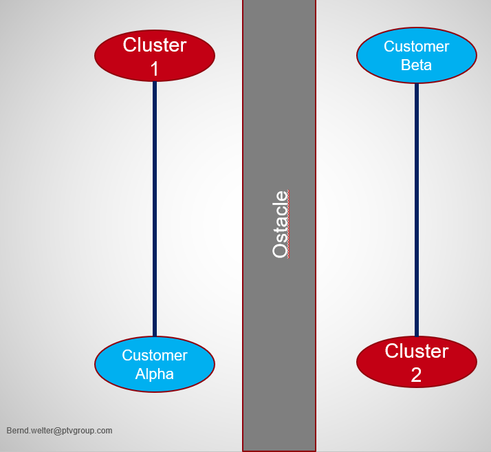

But if we care about the traveltime (and distance doesn't matter) and the driving speed is fast within one of the two regions "east" and "west" the best assignment is the one displayed in this map.
In addition to that I really recommend to split the topics "what is the target criteria? Travel distance or travel time?" from "how do we determine the distance/time? Airline? Dima with shortest or fastest routes?"
