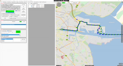

a partner asked me how we determine the travel time on ferries in xRoute2's routing. We compared some well known connections and this triggered some questions:
-  We searched for ferries leaving from DUBLIN harbour. There are two equally labelled ferries towards Holyhead. The partner knows them from his own experience: one of them is a slo one (4 hours) while the other one is some speed boat (2 hours).
 In this screenshot both ferries have been enforced via "combined transport waypoint" - we seem to calculate them both with the same traveltime (4:40) and speed (0). Though there's a small difference in the two polylines (different, but close by  terminals in Dublin) this doesn't seem to be correct
- Could you give us some more details about how PTV estimated the travel times?
- How does PTV determine whether the ferry is able to handle specific vehicles such as cars, large trucks, ...?
