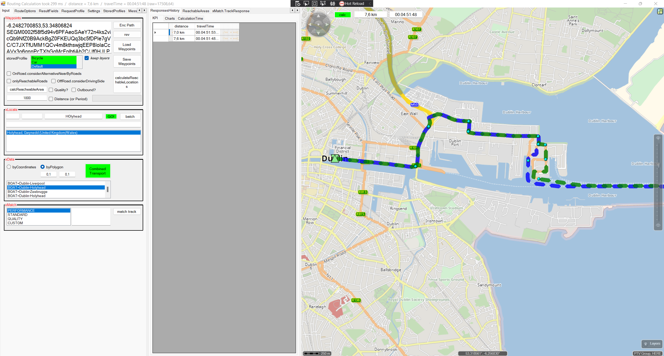

a partner asked me how we determine the travel time on ferries in xRoute2's routing. We compared some well known connections and this triggered some questions:
We searched for ferries leaving from DUBLIN harbour. There are two equally labelled ferries towards Holyhead. The partner knows them from his own experience: one of them is a slo one (4 hours) while the other one is some speed boat (2 hours).<br />In this screenshot both ferries have been enforced via &quot;combined transport waypoint&quot; - we seem to calculate them both with the same traveltime (4:40) and speed (0). Though there's a small difference in the two polylines (different, but close by  terminals in Dublin) this doesn't seem to be correct
In this screenshot both ferries have been enforced via "combined transport waypoint" - we seem to calculate them both with the same traveltime (4:40) and speed (0). Though there's a small difference in the two polylines (different, but close by terminals in Dublin) this doesn't seem to be correct
  • Could you give us some more details about how PTV estimated the travel times?
  • How does PTV determine whether the ferry is able to handle specific vehicles such as cars, large trucks, ...?

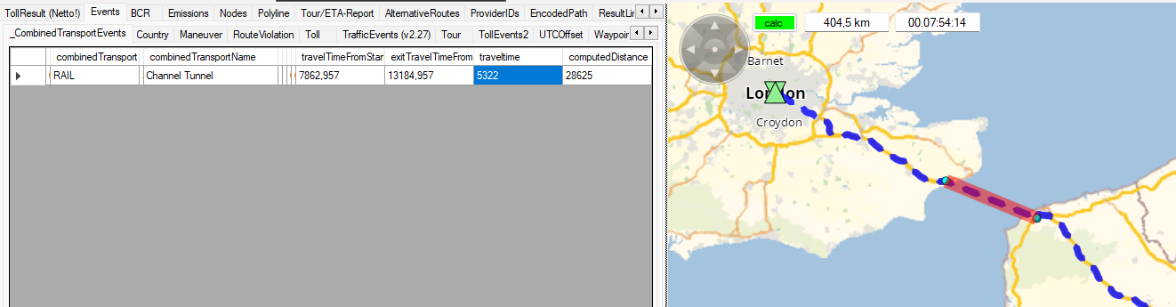

I implemented a sample for this calculation. For the channel tunnel the distance calculated via this approach is about 28.625 km.
Looks good to me!
public double getTraveltime()
    return exitEvent.travelTimeFromStart - enterEvent.travelTimeFromStart;
public double getDistance()
    double deltaTraveltime = getTraveltime();
    // (10 minutes per harbour)
    // (deltaTraveltime * 25 km/h)
    return (deltaTraveltime -20.0*60.0) * (25000.0 / 3600.0);
