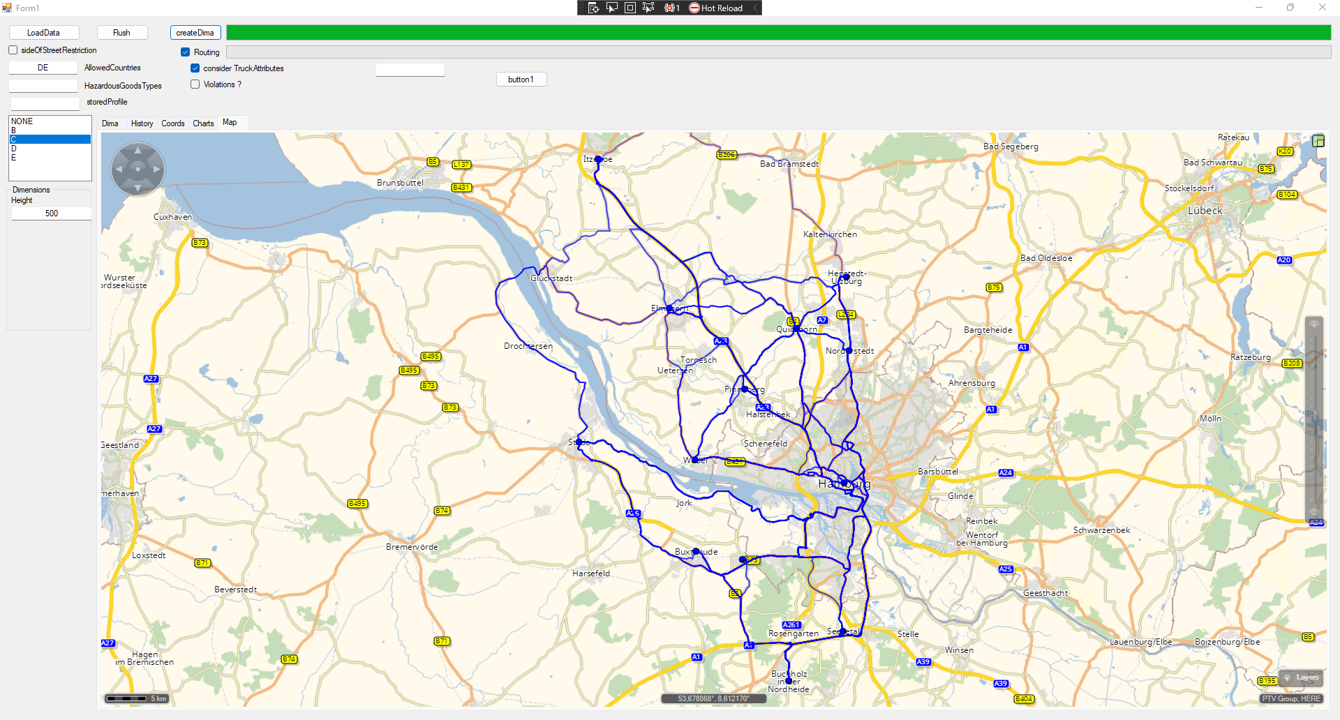

Routing within the region of Hamburg. No TruckAttributes applied.<br />The average routing distance is about 6,177 km. The average traveltime is about 9'547 seconds.

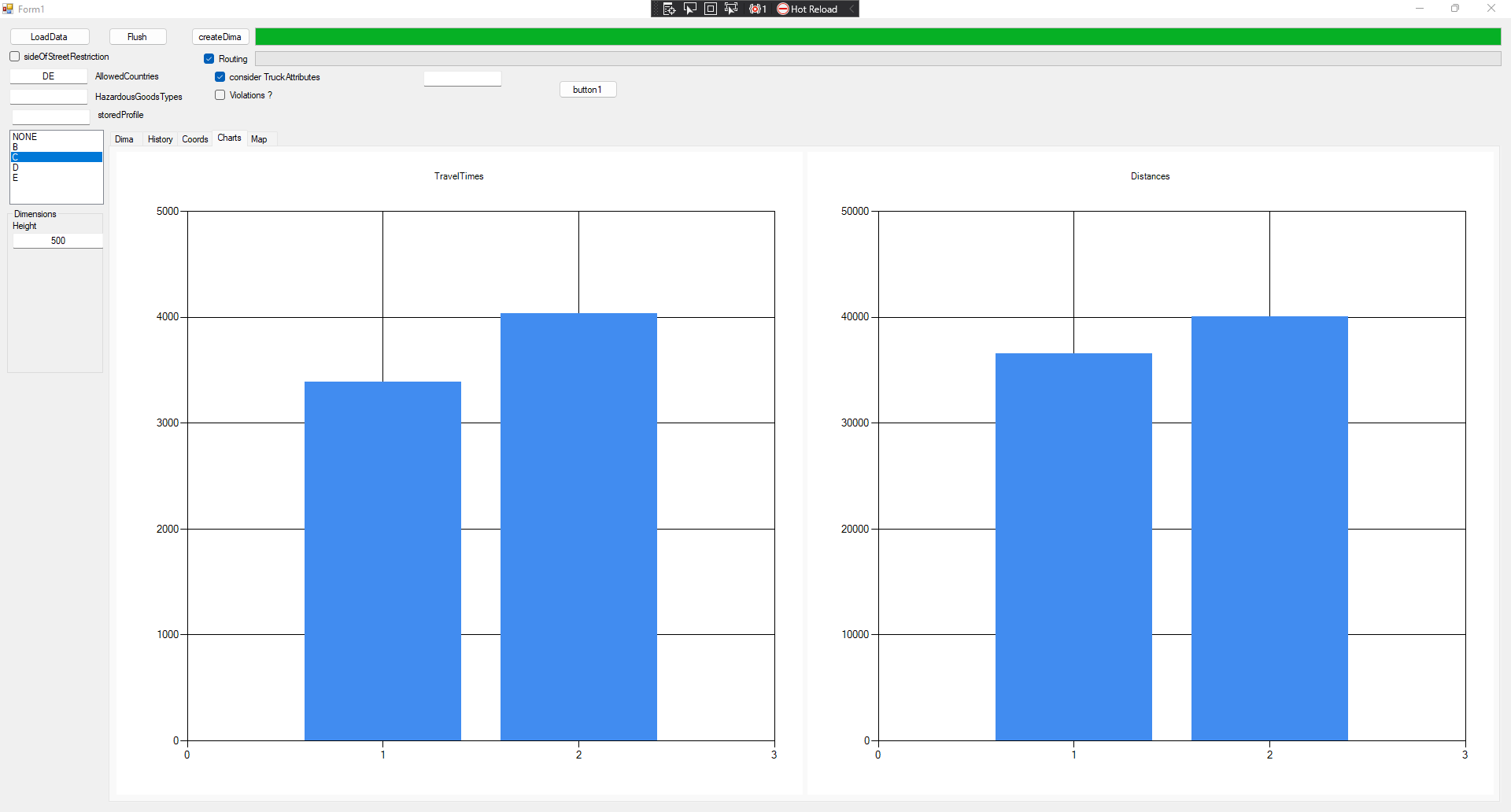

In this sample I applied a vehicle height of 5 meters and activated the TruckAttributes. As the maximum allowed height for the Elbtunnel is 4 meters the routings have to perform detours. <br />Average distance: 6.771 km (+10%)<br />Average traveltime : 11'359 seconds (+19%)
direct comparison
direct comparison
