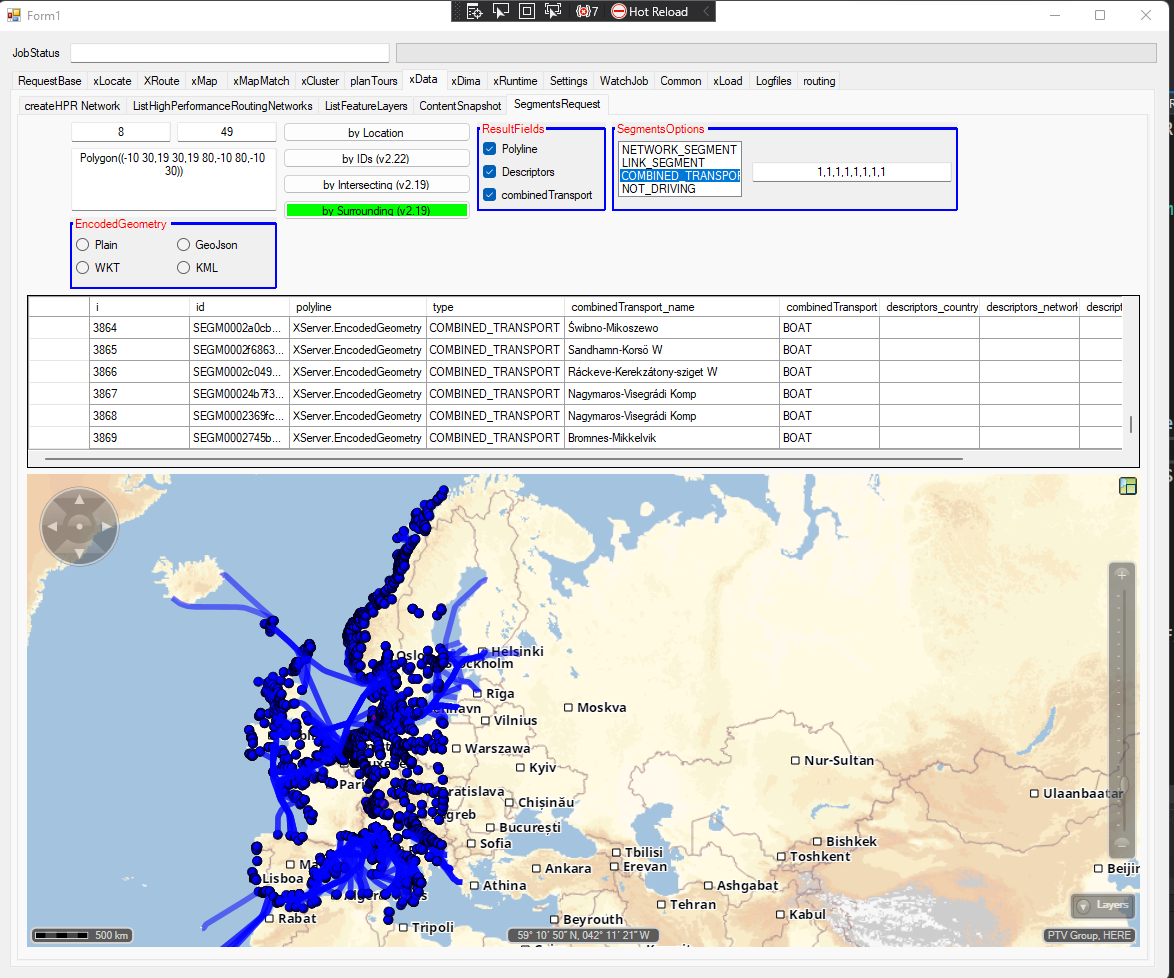

here's a little challenge from a partner who tried to locate a large number of ferries within a map.
I am trying to find few ferry segments, but miss a few. I used both SegmentsBySurroundingPolygonRequest and SegmentsByCoordinateRequest.
I was thinking maybe to create a big polyline to get a whole europe list, but my colleague mentioned that there might be some limitations. Would it be possible for you to share a list of all ferry segments or explain to me how it can be done via api request?
I simulated his request with a large surrounding rectangle and used some parameters to restrict the results of the XDATA2.SegmentsRequest search to "combined transports only". Applying such a filter is required because we do not return more than 5'000 segments in a response.
