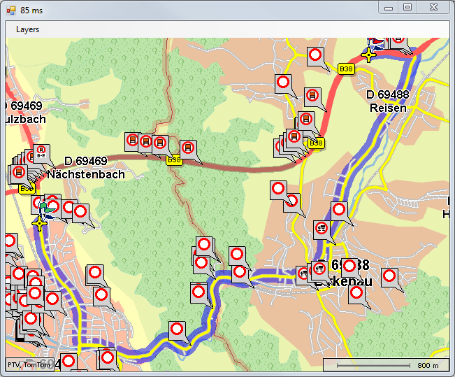

Here is a quick sample that demonstrates the usage. Let's start with the default route through a well known tunnel in Germany: the Saukopftunnel... near the western part of the tunnel you can see the tunnel code icons.
(Mercator waypoints: 963376,6364508 to 968966,6367377)
The following minimalistic XML snippet raised a detour based on the tunnel restriction code:
The map shows the route:
