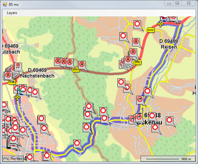

The default route - through the tunnel

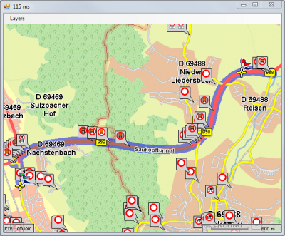

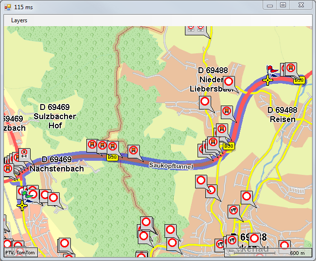

The map shows the route:
The detour based on the code
