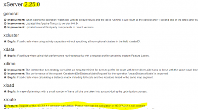

What we name "HBEFA_4" is in fact 4.1 Calculating Emissions for a Routing with a Comprehensive Approach
What we probably didn't implement so far is the return of the CO2e... Your sample mentions 13 properties - which standard is this supposeed to be?
Sorry for the confusion,
Release Notes
Release Notes

The suffix « HBEFA_4 » in the API entities is used to support the latest available 4.x standard (we first hesitated with HBEFA_4_x to avoid confusions, but finally this name was preferred).
Today we have 4.1 data. A version 4.2 will likely be available soon or later. Then we will only have to update the data, without extending the API. This will be easier for the integrators because they will be able to upgrade their emission data without any code adaptions.
Yann:
The major version number ‘4’ is upgraded when there are some changes on how the emission is calculated or when there are new data (i.e. extension of the format). For version 4, there are new pollutants and new information on the LOS pattern.
Then the minor version number just changes when there are some updates of factors.
From what I know, there is no version ‘x.0’. It always start at 1 => 4.1
In xRoute, we just specify version 4, because we know that there won’t be any other pollutants in the future for version 4.x. If there are new pollutants, it will be in version 5…
