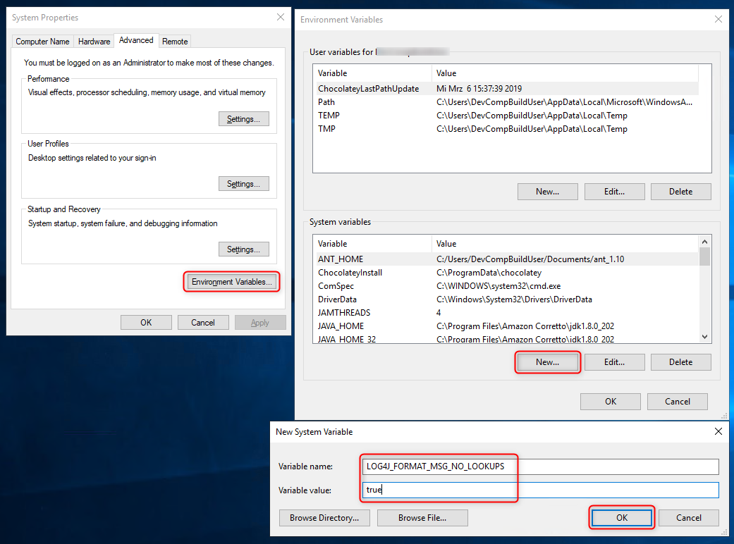

    How to set environment variable:
    • Press the Windows key and type Environment.
    • Select "Edit the system environment variables". A "System Properties" menu appears.
    • Click on "Environment Variables...".
    • Click on "New..." in the "System variables" area.
    • Create a new environment variable with the name "LOG4J_FORMAT_MSG_NO_LOOKUPS" and the value "true".
    • Click twice on "OK" to complete the change.
    This is an action to secure your system in the short term.
