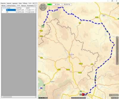

Sample computed on XSI: KOSOVO is bypassed
If you know the IDs of these segments for a specific map version you may use the "custom feature layer" approach which requires you to have access to an xServer 2 with the required map and a license that supports "xData.createFeatureLayer".
If these ingredients are available you could send a "xData.createFeatureLayer" call.

Re: xRoute2: Restrict routes through Kosovo (start in Serbia)
Posted: Mon May 04, 2026 2:20 pm
Some news in this context:
  • Starting with then Map 2026.2 HERE the area of the Kosovo is getting the inofficial, technical countrycode "XK"
  • Based on this it is then possible to identify trespassing this area
    The country elements show a border crossing into the Kosovo area
    and to avoid the region via the well known "prohibitedCountries" feature
    It is also possible to enforce a detour around the area
  • Geocoding is in progress: xLocate2.40 returns the code, but does not yet consider the ""allowedCountries" with the code properly (coming soon)
    The new map returns XK as ISO 2 for the region.
  • 4.5.2026: Already in effect on my local xServer2 - about to come on Developer soon
