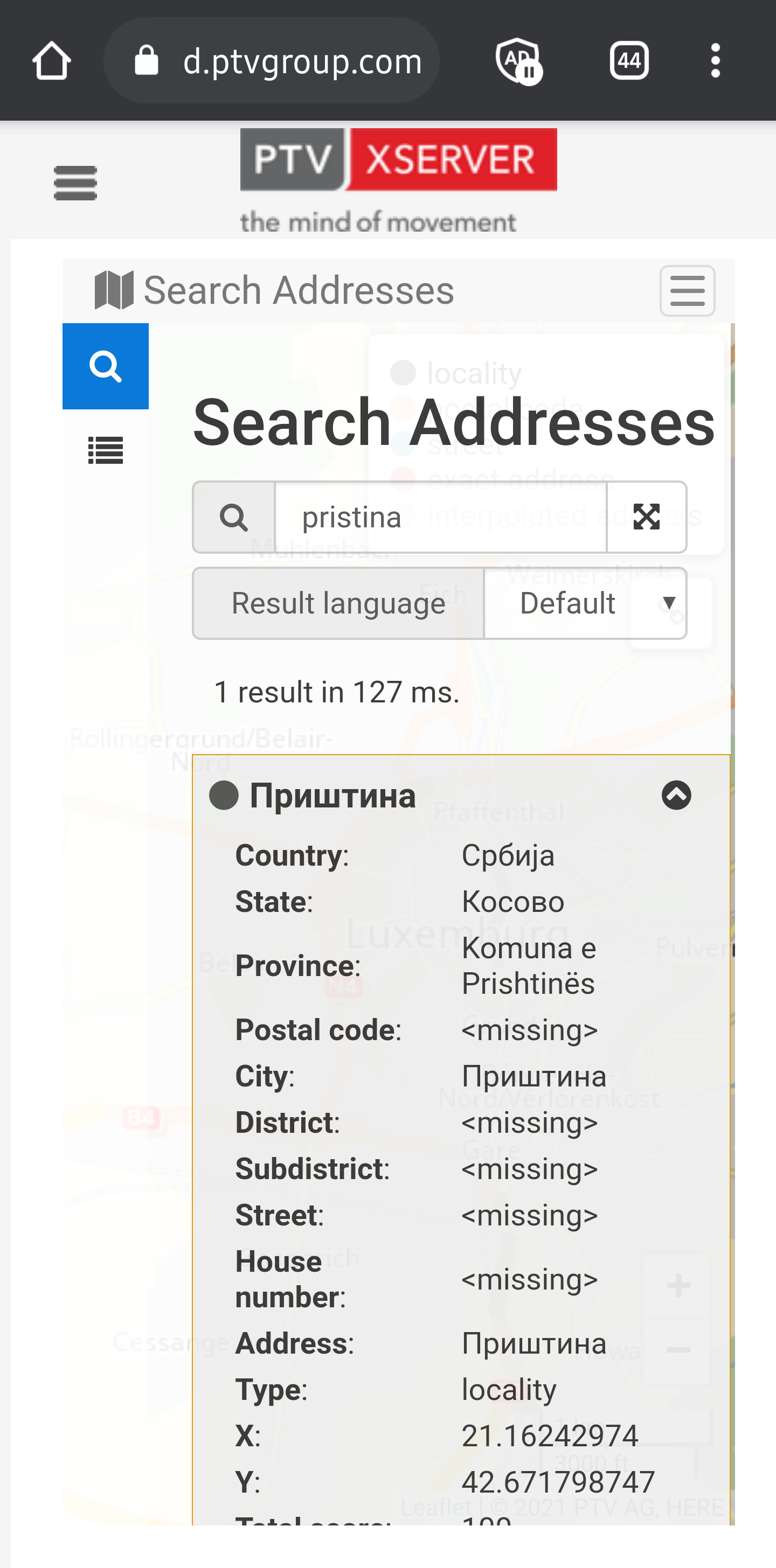

If a place is located in the KOSOVO region "within Serbia" you could identify this via the result address property "state" as mentioned in the screenshot:
Pristina geocoded via xLocate2
So this requires a simple business logic. Not sure how the official, political status is nowadays.
