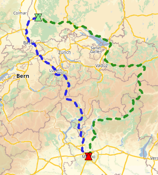

Route from Karlsruhe / Germany to Milano / Italy.<br />Green: forbiddenCountries=[&quot;CH&quot;], <br />Blue: no restrictions set
Green: forbiddenCountries=["CH"],
