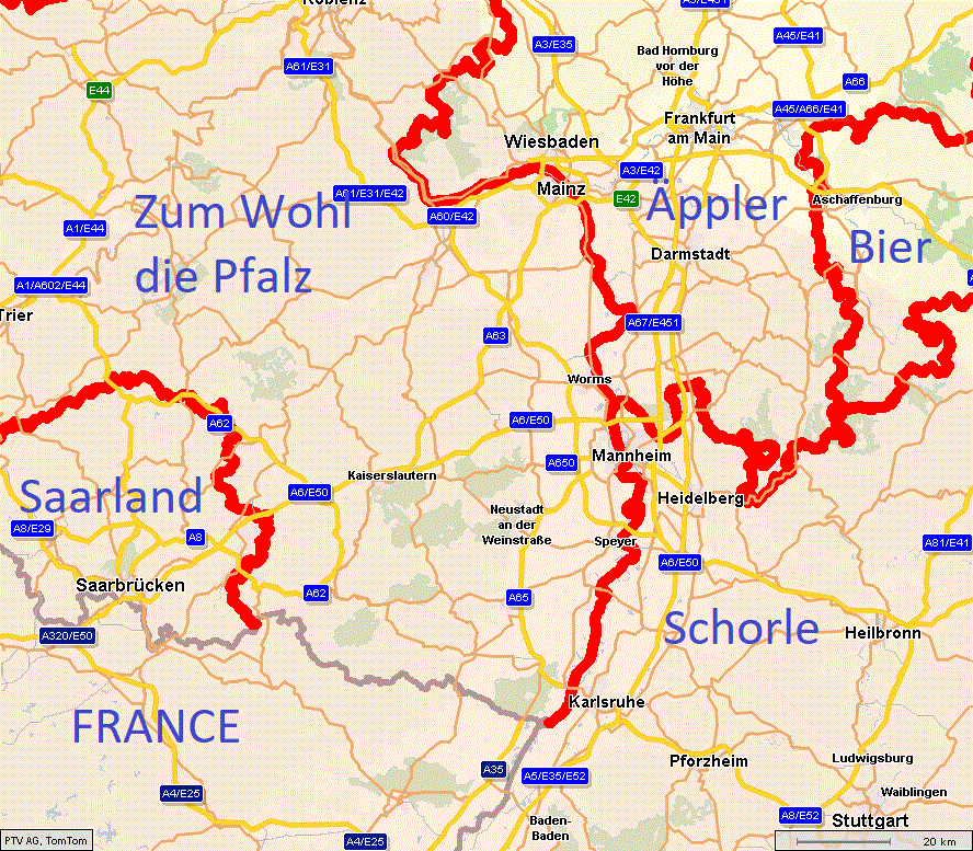

In this picture the federal borders within Germany are highlighted in RED. Names of the beverages haven been painted via MS PAINT ;-)
For the example I manipulated the [config.background.region.width] and it's adjacent properties/keys.

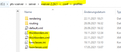

XMAP2: the render profiles have to be located in the  profiles folder (not the rendering subfolder). Put them into /conf/profiles. The showcaseys will then offer them as additional options.
