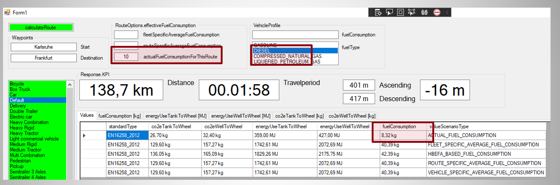

one of my customers evaluates the emission calculation in xRoute. He uses the CEN standard and provides the actualFuelConsumptionForThisRoute. He expects the same value to be returned by the computation but the output looks different. Any idea why?

Hi Marko,
I think your customer did run into a typical interpretation
Depending on the type of the fuel (liquid, gas, ...) the input is treated as "liter" or "kilogramm". (Therefore my testclient doesn't display a UNIT over there). The output fuel consumption is always returned in [kg].
Now as DIESEL has a density of 0.83kg/liter the output of my example (input = 10l actual...) is 8.3kg (and not 10l as expected). And the average density of Gasoline is about 0.74 kg/liter.
Here's a list of the available fuel types and the corresponding densities:
- Benzin (Gasoline) : 0.745 kg / l
- Diesel : 0.832 kg / l
- LPG = Liquified Petroleum Gas : 0.550 kg / l
- CNG = Compressed Natural Gas : 1.000 kg / l
With the bioFuelDensity being :Density = (conventionalFuelDensity * (100 - bioFuelRatio) + bioFuelDensity * bioFuelRatio) / 100
- BIOBENZIN = 0.794
- BIODIESEL = 0.890
