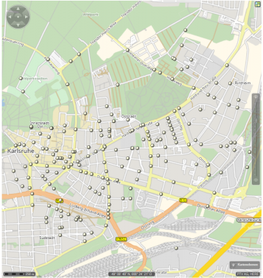

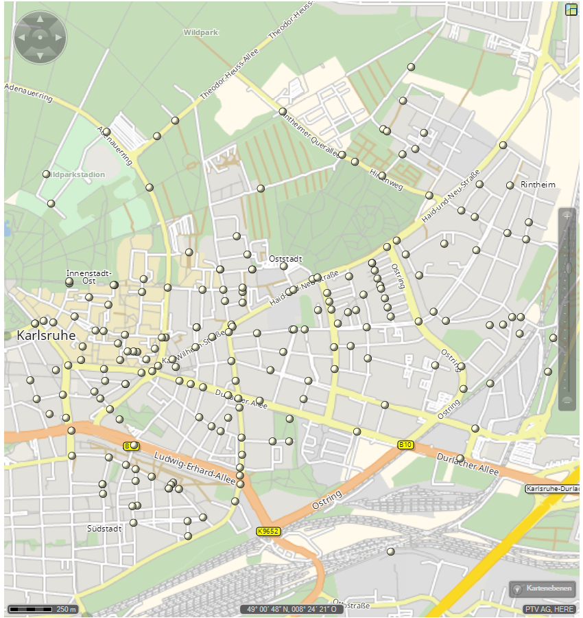

recently I've been challenged for the KEP usecase (parcel) in the following way - maybe the approach below sounds interesting to be discussed. Here's the story:
  • You are given a few hundred locations where you'd like to deliver parcels
    about 200 positions in the eastern part of Karlsruhe
  • As a KEP driver you would prefer to park on strategic meaningful spots from where you could handle several parcels via footwalk
  • Where are meaningful spots to park?

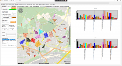

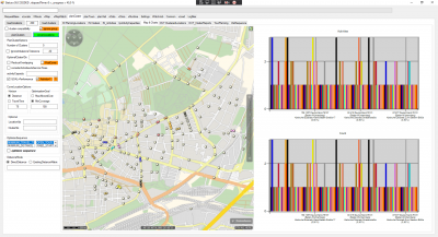

I used the xCluster2.coverLocations API for this. The relevant opjects are:
  • I use the coordinate list of the orders twice: both for the locations and the potential parkings - so in the end each recommended parking spot is at a position of an order (and we can server some more orders from over there)
  • Distance Mode: I used airline but the engine can also refer to a pedestrian routing DIMA
  • CoverLocationOptions I have chosen a DistanceBasedHorizon (75m - 150m - 300m) but you can also use a traveltime based approach such as (1min - 3min - 5min) depending on how much time you would need for a single parking process. Furthermore I've applied a MinimumCoverageGoal of 100% - this is needed because we want to visit all the orders
Conclusion
  • Smaller radiusses lead to more parking spots and shorter local walking trips
    Small radius of 75m  -  each bar in the top right chart is a "parking manoeuver" (about 80). The height of the bar indicates the number of parcels on the temporary local trip (not more than 3)

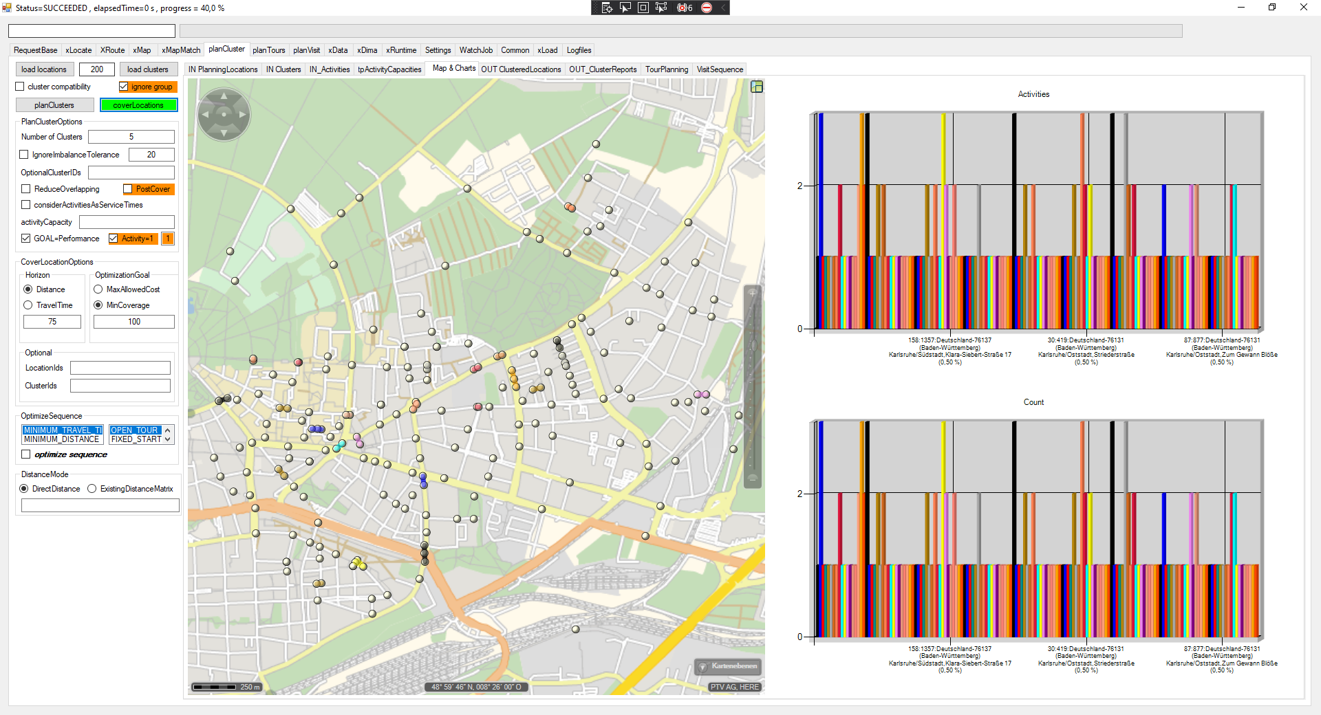

  • Larger radiusses lead to less parking spots (time consuming parking manoeuvers) but also to longer walking trips
    Large radius of 300m - about 40 parking spots with up to 10 parcels on a single local trip

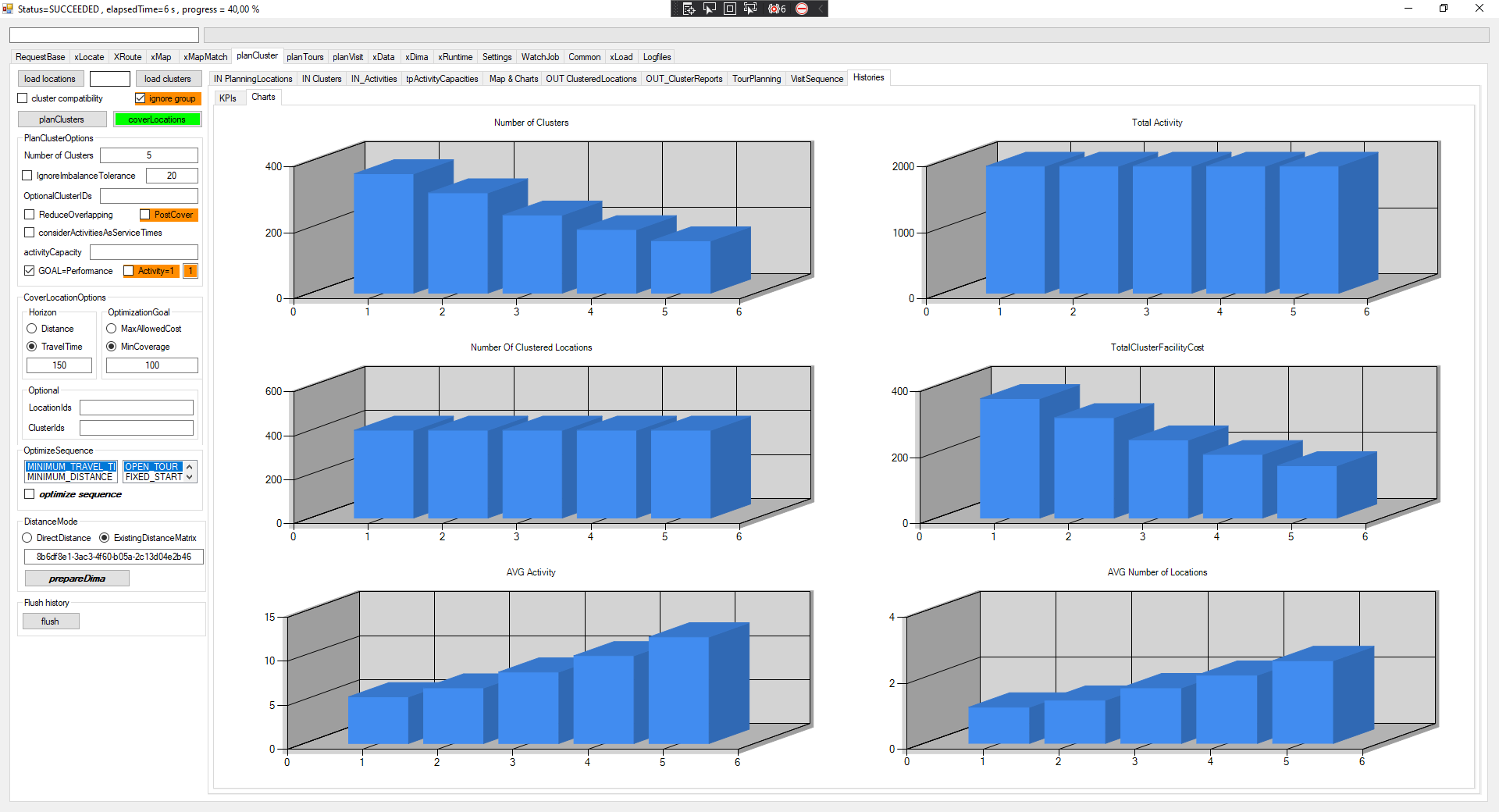

Here's a comparison of the results based on various radiuses: the bigger the radius is the less parking spots are returned. At the same time the average number of parcels per parking grows.

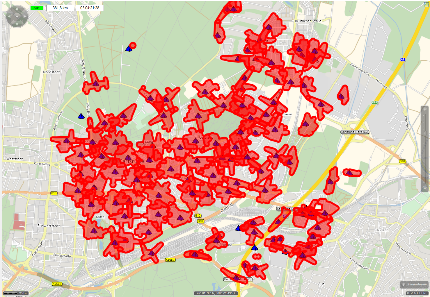

Just to give you a feeling for the proper geometries:
The 300m isochrones around the parkings returned in the sample above
