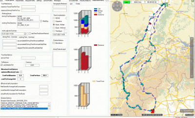

Brilliant. Here's also an example for the difference between cost optimized routing and the old school abstract routing.
- Left chart series / western route: via France - more distance but less overall costs
Right chart series / eastern route: via Switzerland - short distance and shorter driving period but in total more expensive due to the toll costs
Maybe monetary cost optimized routing is also important to consider
