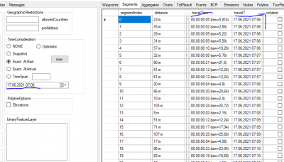

how about checking the
segment'sproperties? There's a "travelTime" value you could aggregate:
- Segment list

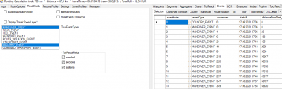

Gathering segments can be time / network consuming. If you are ok with a rough approach you could also look into the event lists and request the manoeuvrer:
- Based on events
