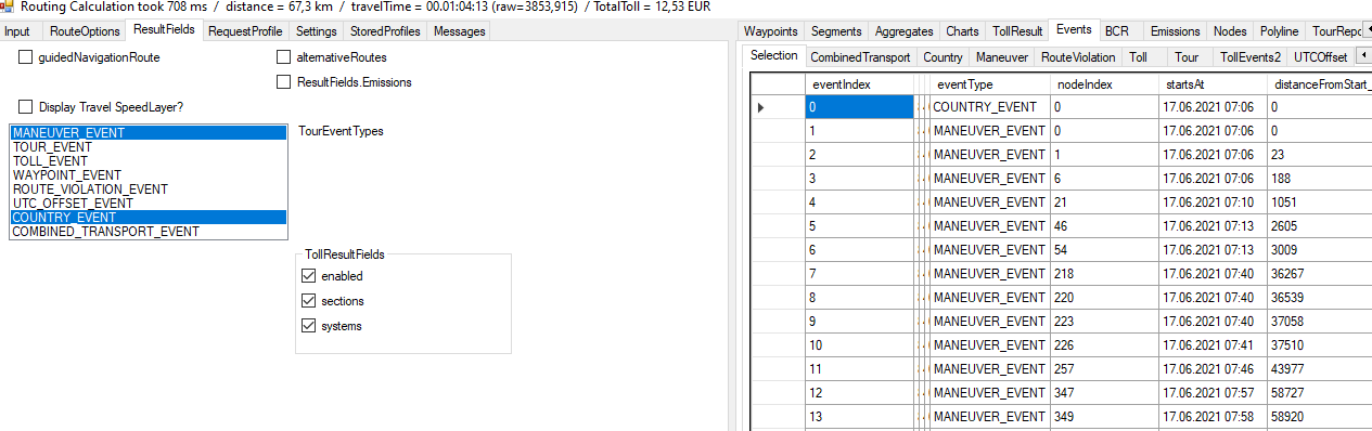

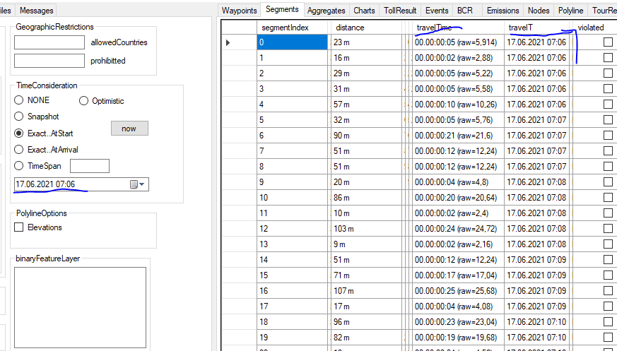

I have calculated route and I know when the truck started trip. Is there any way to calculate the place where the truck should be at the moment?

how about checking the segment'sproperties? There's a "travelTime" value you could aggregate: Gathering segments can be time / network consuming. If you are ok with a rough approach you could also look into the event lists and request the manoeuvrer: Does this answer the question?
