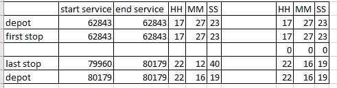

Am I mixing up things: Heres the
Depot, 1st, last and Depot times of the 2215 response.
The last delivey isn't finsished 21:50 but 22:16 (the delivery point has no opening restriction).

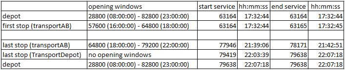

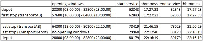

Hey Bernd,
thank you for your reply.
The last stop that you have checked is the "TransportDepot" stop, this stop does not have any opening window.
We use this to return parcels to the transportDepot when not all deliverys were successfull. The tour section is set to 1000, so we are sure that this is planned directly before the final depot
Here is your table with more information about the last transportAB stop:
Request: max22
max22 request/response
Request: max2215
max2215 request/response
And with this information, it looks like xTour is not using the full opening interval for the delivery. Because the end service time for the max2215 request is 21:50:29, but for the max22 requests, xTour says that two waypoints cannot be completed before 22:00:00 and have been removed from the tour.
