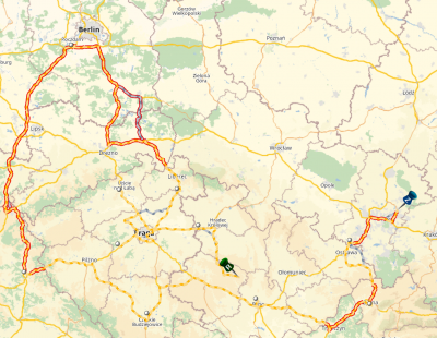

We draw every toll road for calculated route in red color. We have problem with Czech Repbulic. We don’t get information about toll roads in this country. Do you have any solution for this?

Hello Mateusz,
I guess you didn't apply a time consideration mode?
Toll in Czech Republic seems to be time dependent.
If this doesn't resolve the issue please provide complete request and response for an analysis.

Hello Bernd,
Thank you for your help. It solved my problem.
Mateusz
